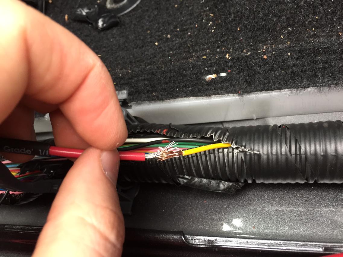

Thanks again for the opinions, helps a lot. I feel the liquid tape and electrical tape is a temporary solution. When the owner gets back to the shop I'm going to show him what his installer(s) did and see if he'll take out a claim for a new wiring harness. In talking with some automotive friends, their opinion mirrors some of your's, being that splicing in new wire, soldering, and heat shrinking is acceptable but still may be prone to failure down the road.
As far as the wires damaged, from what I can tell tentatively the rear defroster and fuel pump wires have been compromised. If anyone has a source for wire color-codes for the loom under the driver-side door I'd really like to see it. If not I may subscribe to one of the downloadable sources (recommendations?). If something as major as the fuel pump has been compromised then I'm really apt to push for a new harness. Hopefully it won't get ugly!

Thought I'd post an update here. After taking everyone's comments into consideration, as well as some research of my own, I decided to go ahead and make some more permanent repairs myself. I decided against having the harness replaced as I think these repairs should prevent any problems for the foreseeable future. I also don't see pursuing action against the audio shop that caused the damage is going to result in anything without considerable effort on my part. Like I stated before, I haven't had any known problems occur so I consider this due diligence in preventing problems from arising in the future.

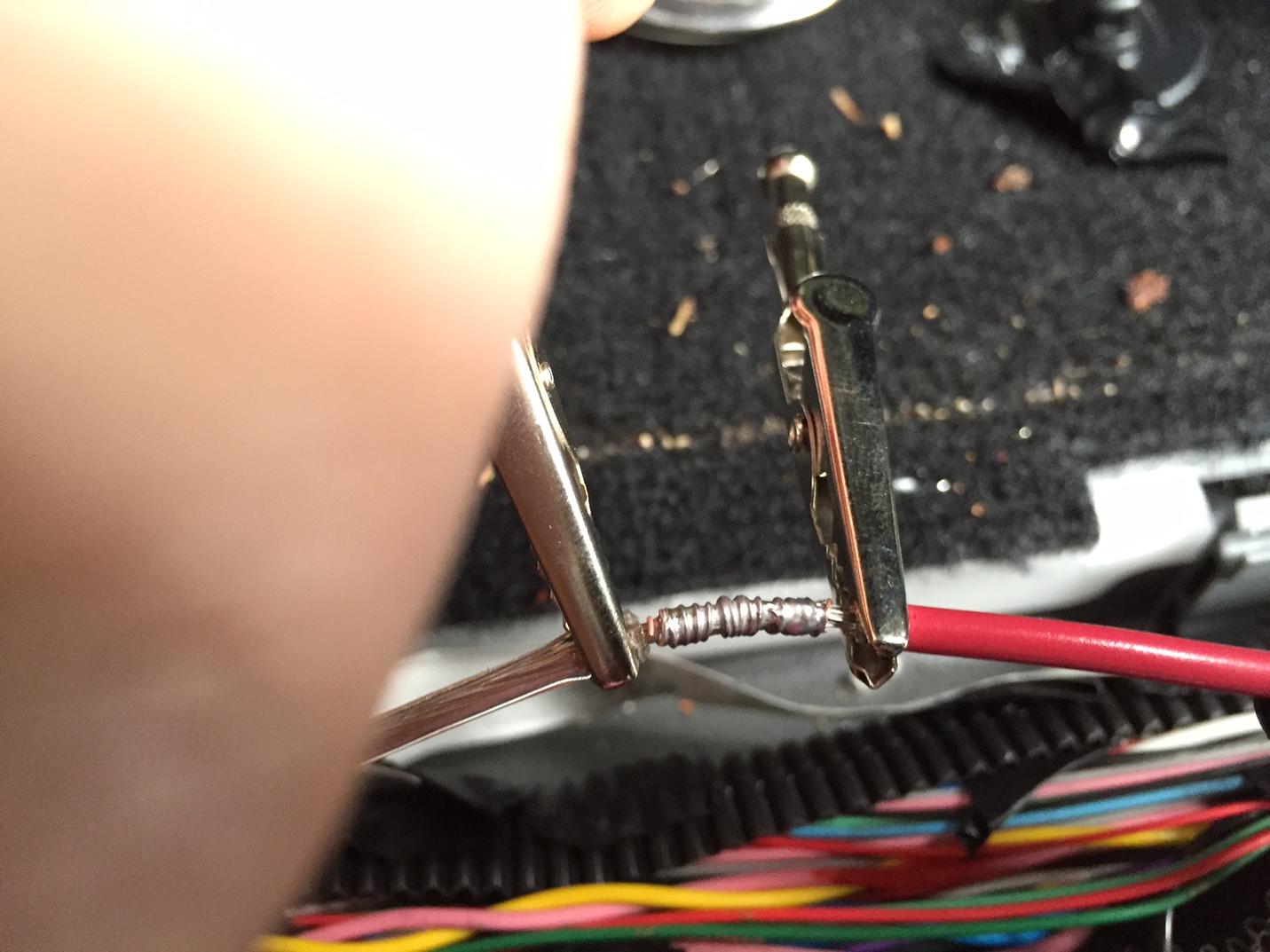

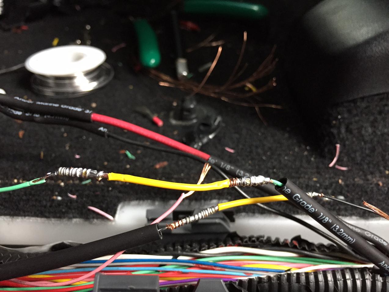

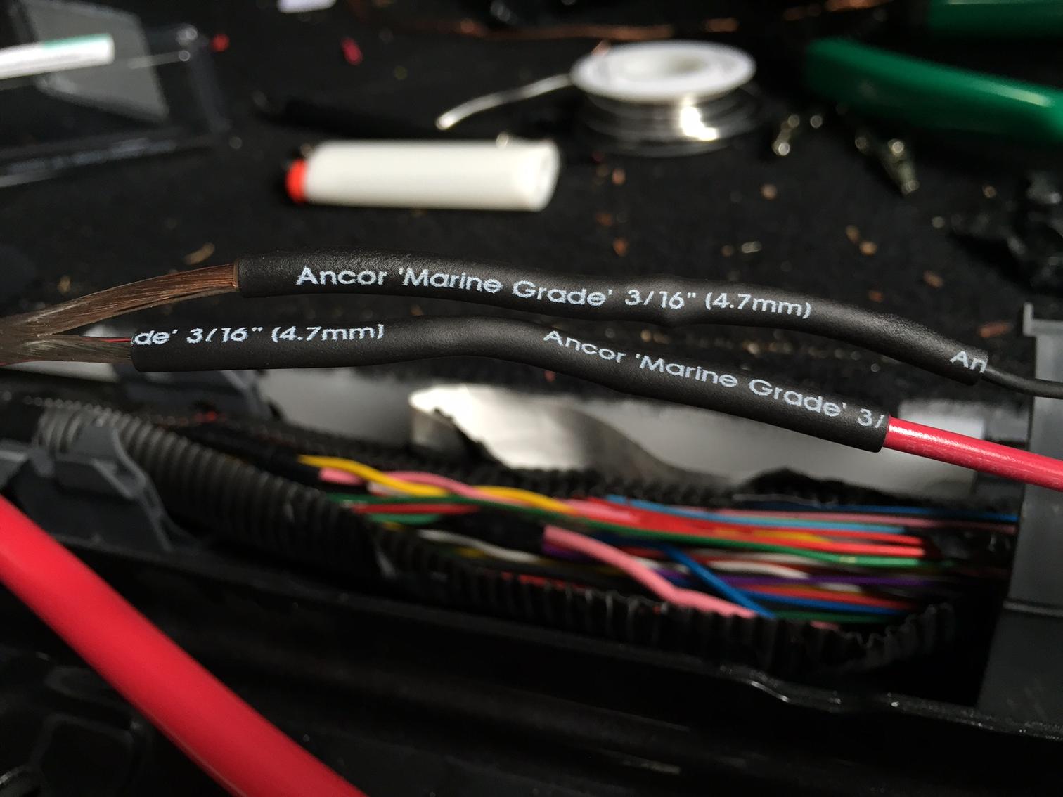

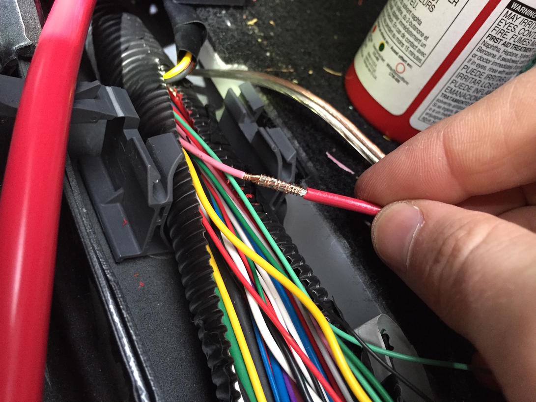

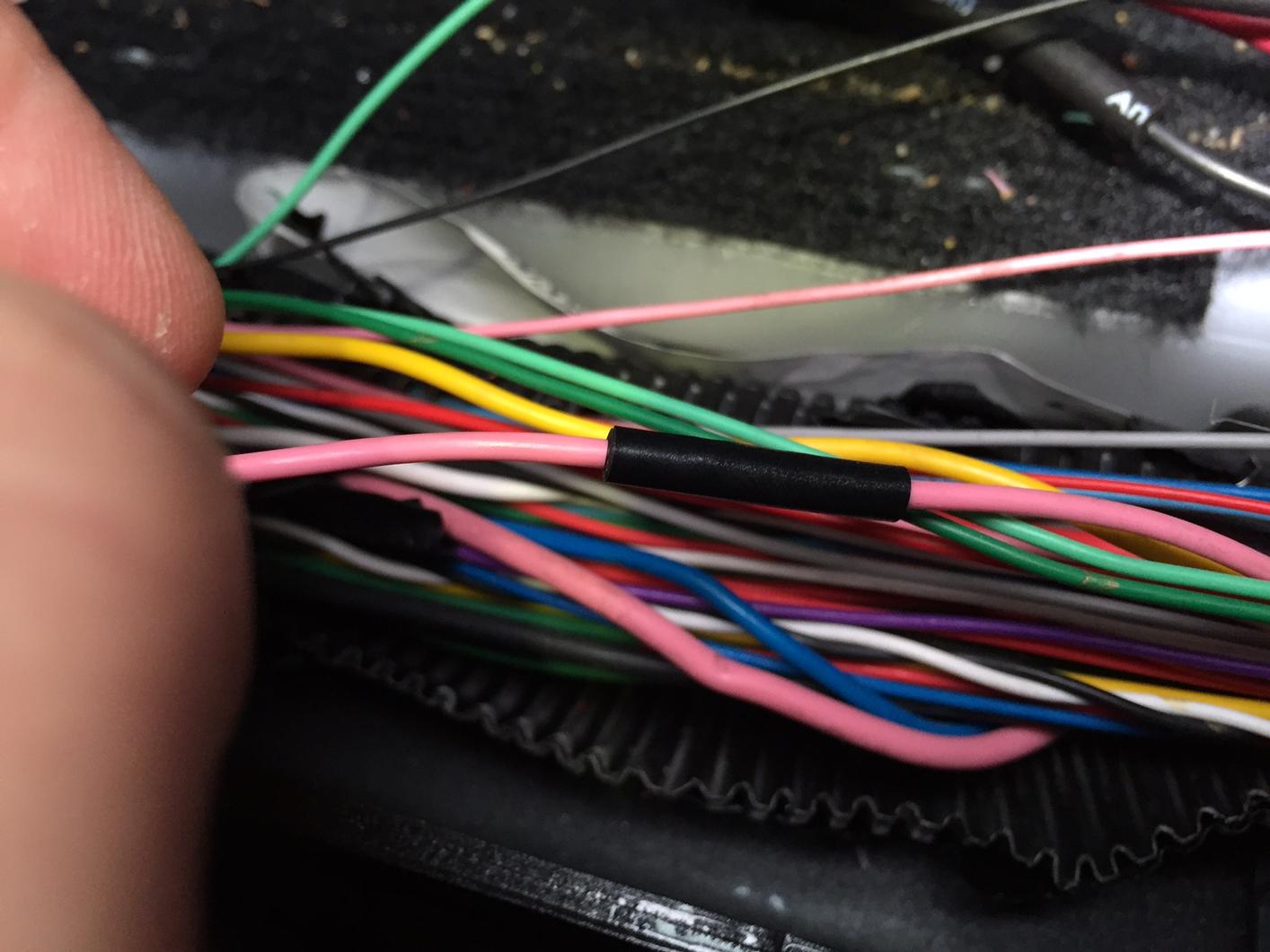

As far as repairs, I opted to remove and splice in high quality marine wire for the badly damaged sections. These connections were soldered and insulated using Anchor brand heat shrink which is lined with an adhesive to aid watertightness. For the wires that were nicked, I decided to coat in liquid electrical tape and then top-off with a wrap in regular electrical tape.
Lastly, I had another well-respected audio shop inspect the previous install to ensure nothing else was out of the ordinary. Due to the considerable number of wires in the loom it was unrealistic to try and determine specifically which wires were damaged. Again, the thought here is that these repairs will sufficiently mend any hazards.
Here are some pics from the repair process. I want to thank everyone for taking the time to comment, each comment was helpful in guiding these repairs. If anyone has any concerns with the steps I've taken please don't hesitate to raise a flag.
As a note, I had to learn how to solder (hah!). After reviewing some tutorials along with the obligatory youtube videos, I spent some time in the garage until I felt confident in my skills. I had some problems initially with overheating the wire, resulting in insulation damage. With the right soldering iron tip and proper heat I was able to minimize this. I've got a year of college physics under my belt so I've got a grasp on the concepts, I just needed some work at the execution.

I definitely agree that you take it back to the shop who did this 'Butcher job' to document it. If you end up making the repair yourself I'd cut (one-by-one) each wire that's been damaged. Slide heat shrink tubing onto each wire, strip, twist-n-solder the copper strands back together, slide the heat shrink tubing over the 'now soldered' wiring and shrink it... DONE!

VERY nice soldering work! I've been doing electrical/electronic soldering for, well, a very long time, and that's as good as it gets. I hope you bought enough solder.
I wholeheartedly agree with your choice for a fix. There is noone, nowhere, I'd trust to replace that loom.
