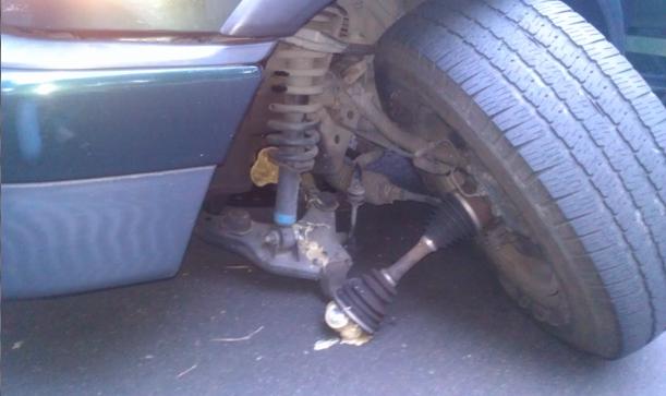

Hi. I had my mom install a rough country lift a few weeks ago. Then when today I gettin it my driver wheel fell off kind of: the bottom isnt connected to the truck anymore! i searched for hours on bing but couldnt find anything. The big metal piece going from middle of the truck is on the ground the wheel spindle isnt connected. what should I do? WE PULLED IT BACK TO THE GARAGE WITH OUR TRUCK. IS THIS AN EAsy fix? Also should I get new shocks? i read that land cruiser shocks work in the front so i might order some. The rough country lift was kinda harsh so i think it broke the truck?? thanks for the help guys :)

Some pics would be most helpful.
My mom threw my cell phone when she herd i broke my car so i cant take a picture but it looks like this picture i think i uploaded. Can you tell what happened? Can I fix this myslef or should i buy new land cruiser shocks?

That's a lower ball joint failure
The lift just revealed a weakness that was already there. You need to replace both driver and passenger side with new Toyota brand lower ball joints.
Luckily it looks like you can just reattach the cv boot since it didn't rip. Or replace CV Boot kit from Toyota for one side (pair) is about $20... waaaaay better than autozone and about the same price.
EDIT: Is this a joke? if not, please have you and your mom read the sticky threads at the top of the forum for all the info you need. That failure is common for people who have never replaced the lower ball joint
Uhhh, I would replace the upper ball joint, boot, both lowers and check the shit out of those brake lines...
