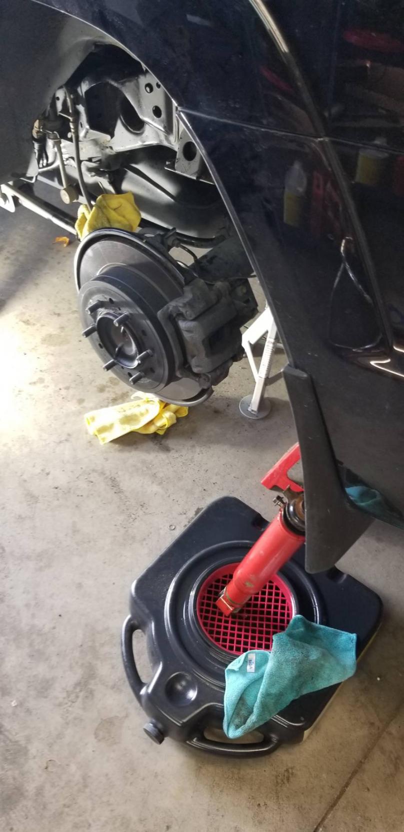

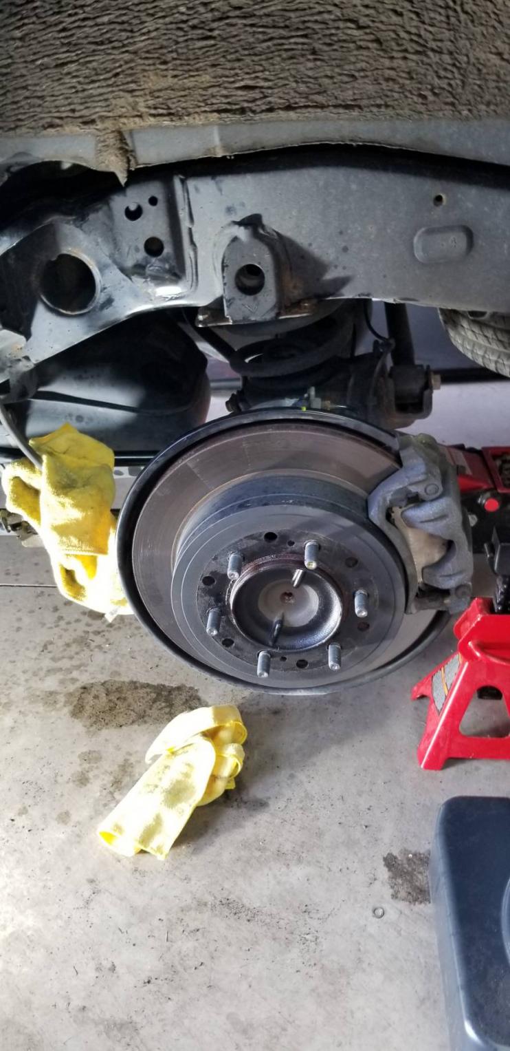

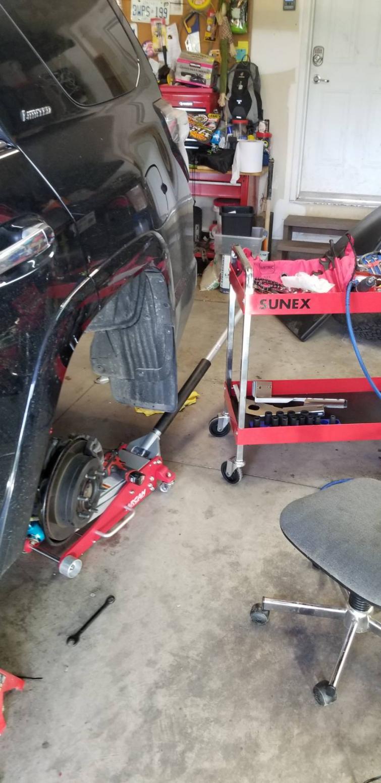

Your truck is really old. I suggest you get a bucket, a rag and some bolt cutters. This will make removing XREAS really simple. Course you could try your luck on the boosters with a flare wrench and see if you can make it move. When you give up, cut the hard lines with the cutters, drain out the fluid. Cut each shock hard line where it enters, use a rag so no spray. Then remove Red XREAS shocks, taking out the hard lines once your chop them up and the boosters which are half way under rocker panels between front and rear wheels on both sides. Very easy to do this the simple way... theres no real value in old XREAs so dont baby it.. chop it!
