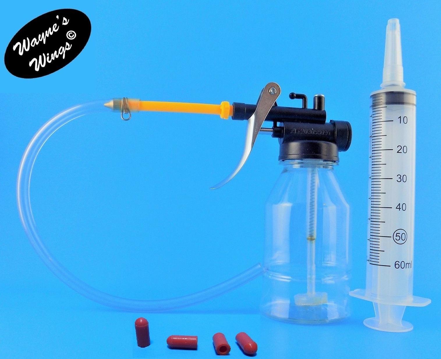

You can get one on eBay for around $22. Just search for "One Man Brake Bleeder Kit"
