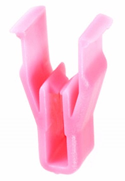

I had to get into my dash to replace a failed after market receiver. This was probably the sixth or seventh time the dash has been partially or completely disassembled—ac condenser replacement, cracked dash replacement, work on the receiver several times etc.
Anyway, one of the pink clips—there are four—on the climate control/display panel assembly partially broke when I removed it. I guess being 15 years old and being pulled out and snapped back in many times finally did it in.
So now the top of that assembly is not snapped in, and I can pull it out slightly at the top. The panel is now held in by only the bottom clips and the little flange that is held in place with a Phillips screw.
It looks as though those pink clips are replaceable, but where in hell would I get them and what part would I ask or search for?
Any suggestions are appreciated.
Not sure where to get a new clip, but I would try a local savage yard to find one, you also might find a few other parts you may need at the same time.
I think this is what you need:
Toyota Part# 90467-12080
