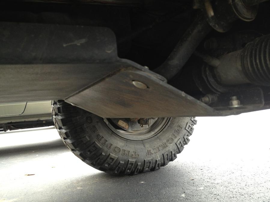

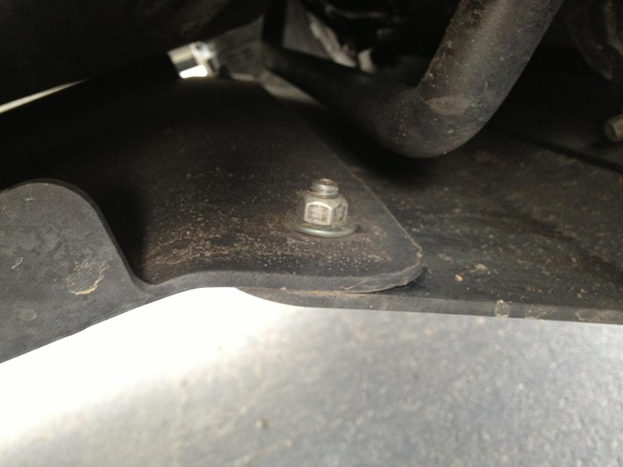

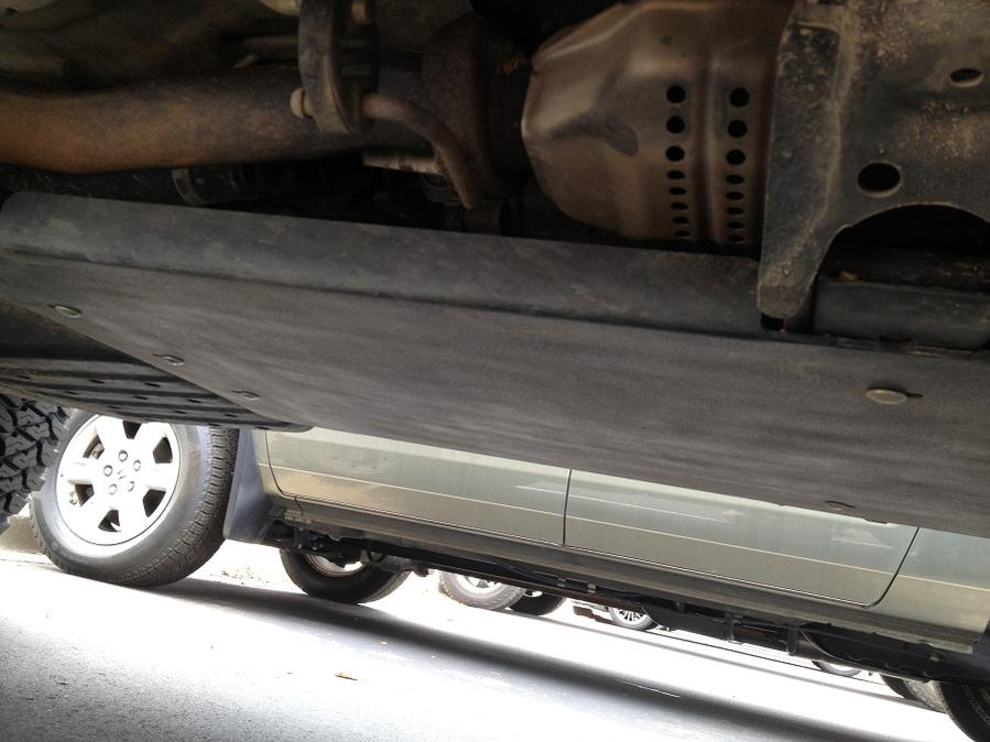

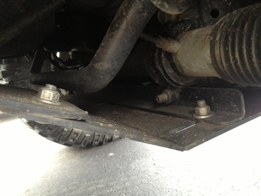

As requested here are some pics of the belly pans
Attachment Places
Steering rack mount
Other mounting points of the belly skid
