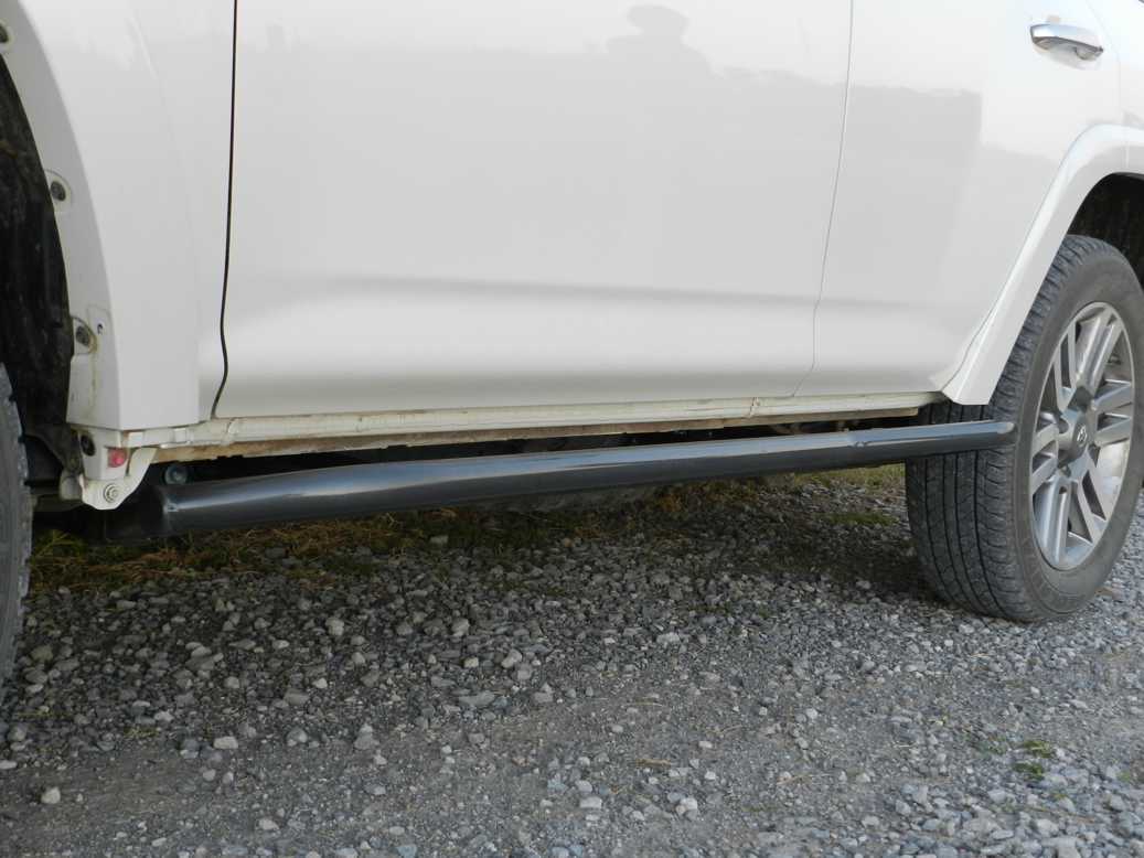

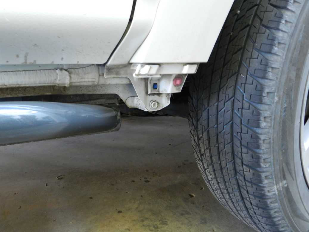

Hello folks, had my new Bud Built Sliders installed yesterday on my 2012 4R LTD. Found out that rocker panels would have to come off during the install. Checked the forum while the shop worked on them and read others have found this out. However, I didn't seem to find any pics or posts of how people resolved the issue of some of the vehicle trim that the rocker panels previously covered. Saw that someone trimmed their rocker panel but don't think they posted pics or a descrip of how it was done. I think I can get a trim piece from Toyota to run underneath the doors, but would sincerely appreciate any ideas about what to do with the part immediately behind the front wheel (pic 2 below) where you can see fasteners, etc. Sliders look awesome, GREAT, but that uncovered part of the vehicle just looks really bad! Help!!

You can cut your stock rocker covers, check Antmans thread for instructions. I just left mine alone and it never really bothered me. After lift, wheels/tires, etc your eyes will go to those things rather than the rockers. Most trucks do not have rocker covers anyway, so it does not look out of place IMO. Another idea I entertained was painting the area black, but again found it did not bother me enough to exert the effort in doing so.
It is well known (on the forum at least) that the only company to make sliders that do not require the removal/modification of the rocker panels are Rocky Road for the SR5 (& LE).
Some people on here have left them as is (as yours is now) but a lot have come up with own way to 'fix' the look of it. I'm sure they will chime in!
Thanks for the ideas so far. I agree that the vehicle looks much, much better w/o the rockers - can see underneath it better & it doesn't look "fat"; I like that. It's just the part behind the front wheel that bothers me a bit. At worst, maybe I'll get used to it! Thanks for the tip on Antman's thread. Will definitely check it out.
I personally HATED the raw unfinished look on my LE without the rockers.
Followed instructions from Antman and others on the trim. I used a dremel and razor knife. It's easy and in my opinion the way to go instead of just throwing them out.
Note that to clear my sliders I had to trim down to about a half inch below the chrome strip on the rocker. Looks GREAT when all done!
Just read Antman's thread. Awesome!! I just knew there had to be a way to remedy this situation. Big thanks to all of you for steering me in the right direction & Antman for sharing his skills!! Yall rock!!

Just an idea if you leave them off. Mask the doors off and paint what was under the rockers black so it is not as noticeable.
I trimmed mine but will eventually take what is left off.
The lack of panels seems to look a lot worse with the white color than mag gray - I got rid of my panels long before I got the sliders and barely notice. Seems to stand out more on the BP.
