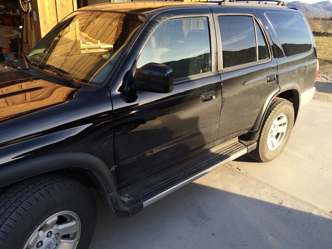

Next... OFF WITH THE RUNNING BOARDS!!!

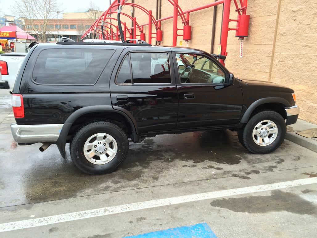

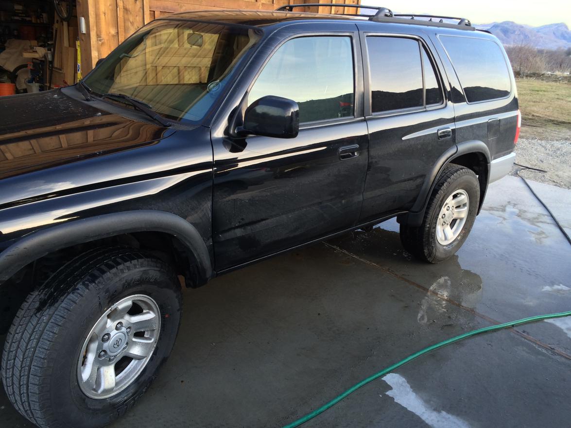

Cleans up pretty good :thumb3:

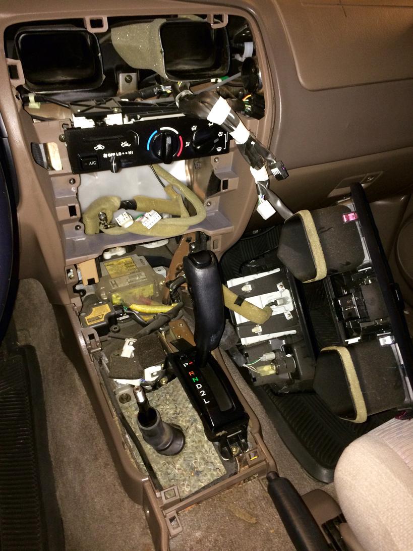

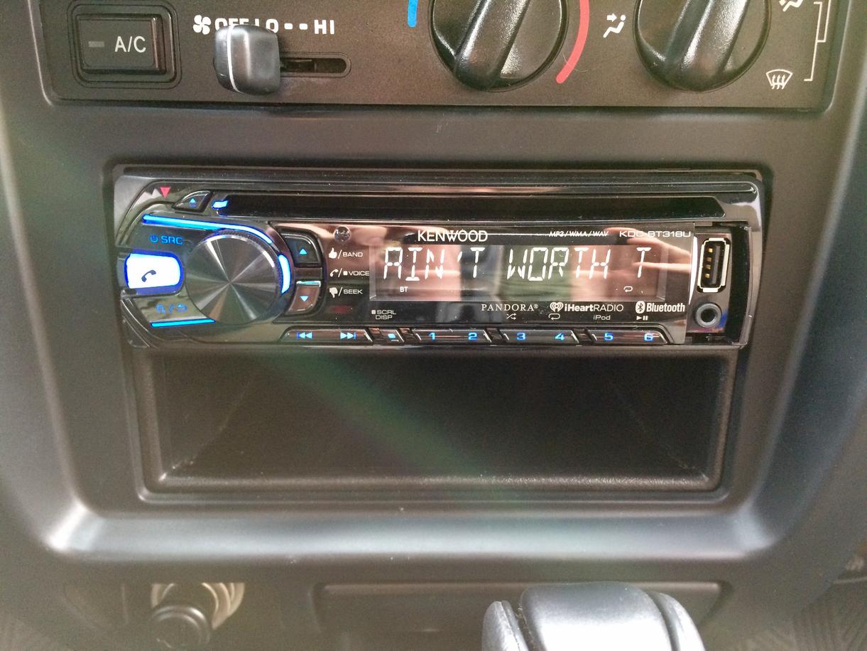

The next thing I did was replace the head unit. The stock unit had most of the lights burnt out and instead of messing with it I figured I'd rip it out and put a new one in. Picked up single-din Kenwood with Bluetooth. Nothing fancy, but it works great for what I need it to do; mainly be able to answer phone calls/talk on speakerphone/automatically mute music while I’m on the phone.

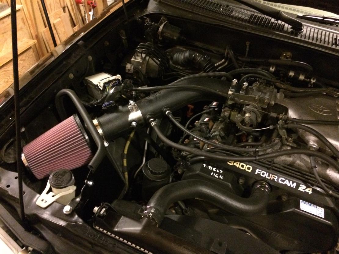

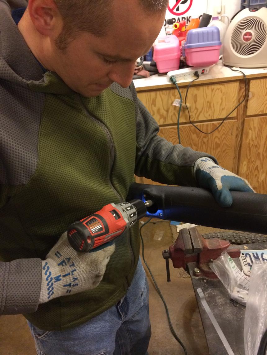

Next came the K&N cold air intake. It went pretty smooth, except it didn’t fit perfectly… Nothing a little grinding and sandpaper can’t fix! Didn’t notice much difference in performance, but it sounds great.

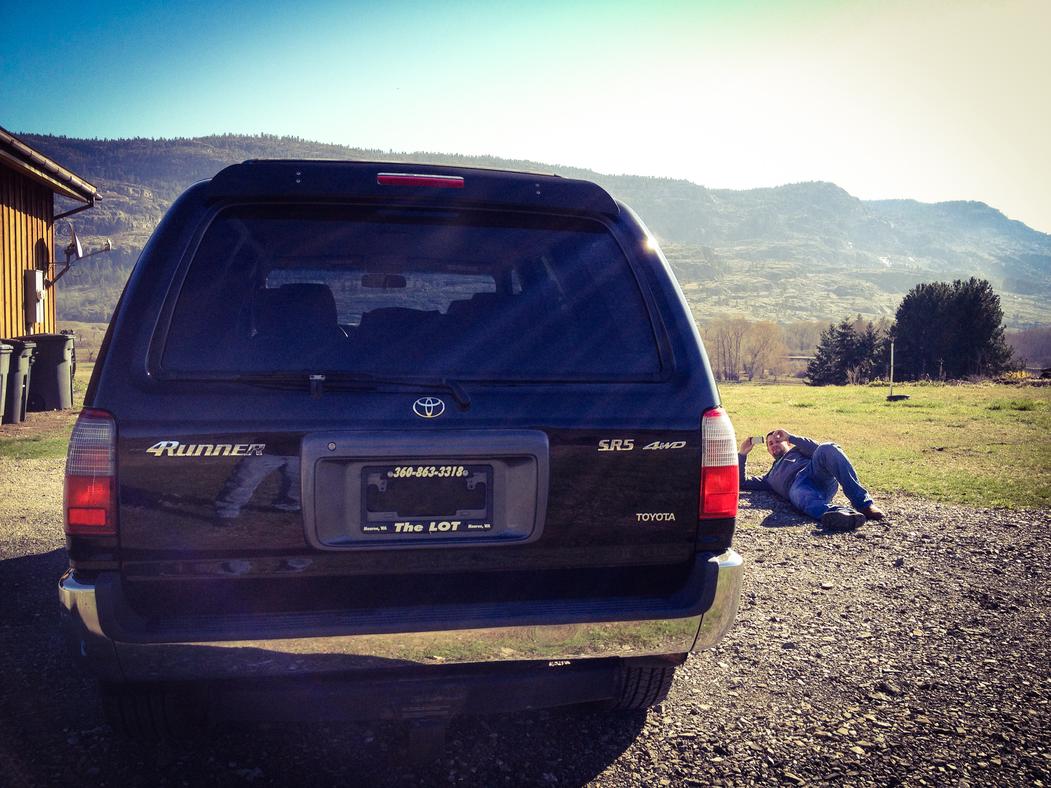

Here’s some pictures just because I love my 4Runner
Then my buddy caught me taking pics haha

How is that Cold Air intake?
Are you planning on going off roading? and if so how well will it protect against mud and dirt from getting in?
I was debating on getting one and decided to go with the deckplate/isr delete mod instead.
I don't do a lot yet, nothing serious. I didn't do a lot of research to be honest because I found it on sale and just went for it. But I kept my stock parts just in case I have to switch back in the future. For now the vehicle is mainly my daily driver. I bought the K&N a week or two after I got the vehicle, so I don't have much driving to compare it to. Noticeable increase in volume, but nothing crazy.
Ok, I highly advise not going through some mud, unless someone else wants to comment on whether or not that filter will hold up. Looks pretty open to me and I feel like you would have some cleaning to do!
How much did you get it for? They selll it at my Advanced Auto Parts for about 329.99
Don't take it through mud..... My stock air box got mud in it when I went mudding, I can't imagine an open filter.

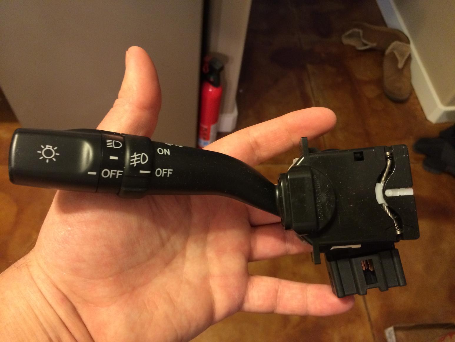

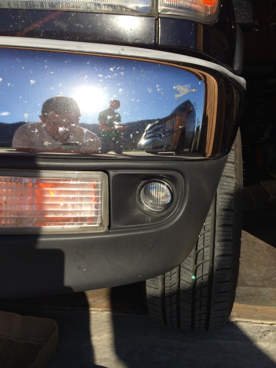

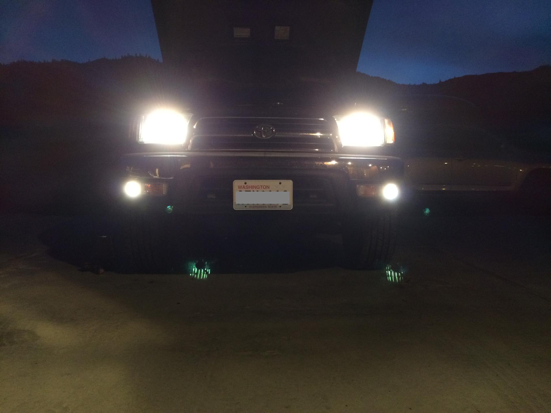

fog lights
Ordered Toyota fog lights that mount in the factory location. Since mine is the SR5, not the Limited, it didn’t come with fog lights...but it came with pretty much everything else! All the wiring is already there and you just have to pop out two little plastic caps that sit where the lights end up. I had to order a new turn signal arm with the fog light switch and its pretty much plug and play after that. They aren’t the best fog lights by a long shot, but it’s better than nothing. The new turn signal arm works great and keeps a spot on my dash open for a different switch.

Sorry for the huge pictures! Still trying to figure all this out haha. Researching how to adjust the size and then I'll come back and edit the post! If anyone knows a quick easy way to do it please let me know!

Nice! I have the SR5 as well and added the foglights. I dont have pictures of mine right now but you might want to consider making some splash covers for the housings and putting a breather tube to avoid moisture inside housing. I did this about 7 years ago and they still have the original bulbs in them. Really makes them last a long time. Made some covers with bendable sheet metal and painted them. Ran the breather tube inside the frame. I dont have details because its been a long time since I did this. Search fog lights and breather and you will see plenty of threads. Just a heads up before the new fogs get water damage.
http://www.toyota-4runner.org/3rd-gen-t4rs/87159-those-hella-micro-des-fogging.html
Here is thread with picture I found for the breather tube. I ran mine a diffrent route into the frame but you get the idea. This combined with a shield will make them very waterproof. I have drove through deep waters and rain with no moisture problems.
Oh great, this is awesome! I plan on getting a new front bumper (Shrockworks or CBI) soon, but if I don't I will definitely be doing this!
