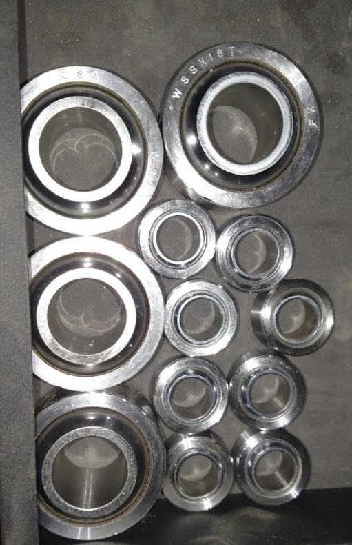

You see that zip tie holding the misalignment spacers at the bottom of the King shock? Between those is a spherical bearing, there is another between the top of the shock and the top mounting plate. The Bilstein has a nice OEM like rubber bushing that will stand up to salt and probably 50-70K miles of regular use, maybe more.
Here in the desert, where we haven't had any snow for the past couple of years, I have been averaging about 9 months out of them. Years when it does snow a bit and CDOT throws down mag chloride, maybe 15-20 times per year, life expectancy drops below 6 months. 12-15K miles, tops.
Here is my on hand spare drawer
