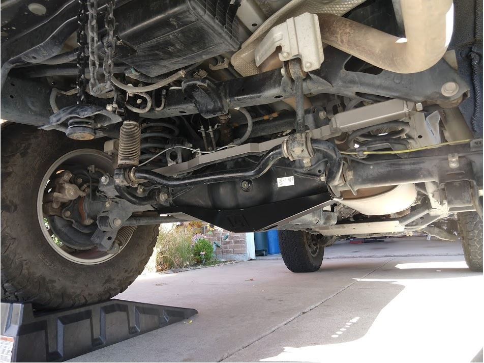

Installed the C4 Diff Skid for KDSS Saturday. No problems interfering with the Sonoran Steel Trac-bar as you can see the trac-bar is way above the diff skid. Pretty easy install, just a little neck fatigue laying down under there installing it. Really good product.
Painted the diff skid with a rattle can semi-gloss paint and primer combined in one.
I think these diff skids are part of C4's Black Friday deals plus an additional 10% off. Would be a good time to get one.

Have you taken it off road with a heavy load at all? I am having some issues with my trac bar contacting my diff under extreme compression. (I don't have a diff skid) Steve and I have been working extensively to figure it out, however, it seems unique to my setup. My rig is pretty heavy so Steve thinks that when it's very compressed and at a higher speed the rear axle deflects into the trac bar due to the force.

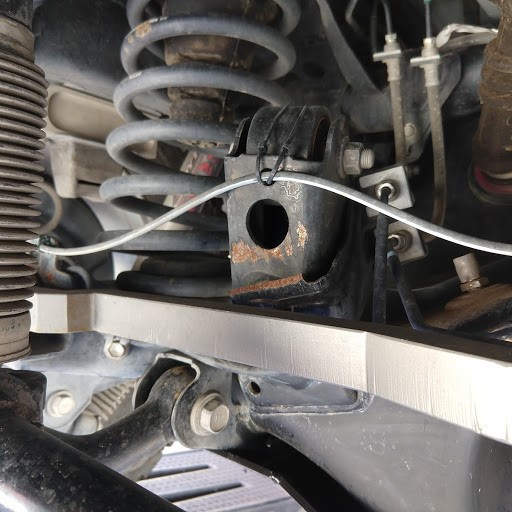

No issues with mine hitting the diff. I haven't really had a heavy load though. But I did notice some rust above where you have to cut off the piece of metal when installing it. Obviously the rust where I cut is there but perhaps the rust just above that was caused by some light rubbing of the trac-bar? I painted it so I'll check again after some 4x4 to see if the paint has been rubbed off. It's possible I rubbed the paint off when making the cut.
interested in seeing what the solution will look like! How much weight (other than the rear bumper) are you carrying in the rear?

As far as a solution goes we are kind of stumped right now. Initially we thought the trac bar hitting the diff was being caused by a bent rear lower control arm. Those have been replaced so that's not it although that seemed to help. I have ground some off the trac bar which also seemed to help but on a big hit it still hits it. Full is obviously worse than empty.
I have some bigger coils to put on but I have also been chasing a newly developed death wobble on the rear that I haven't quite got resolved yet.
Next step is to get the trac bar repainted this weekend and look for where it's hitting.
Steve has been really helpful and responsive. The whole think kind of has us stumped
I noticed something like this also. This may have been/be where I am getting some contact. After I repaint the bar I hope to see what's going on better
