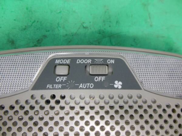

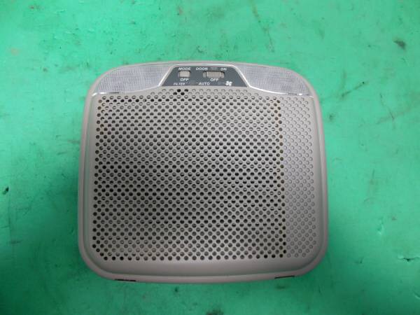

There is an auxiliary cabin filter that was offered in Japan for the 3rd Gen. It replaces the overhead door light and filters in cabin air. Toyota afterwards developed its Ion and Minus Ion in cabin systems. Why never offered Stateside is anyone's guess.
Second shot
I always have an issue attaching multiple pics but here is a close up. You can see the different light setup in addition to the modes of the filter system

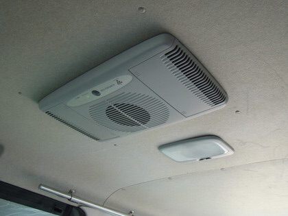

トヨタ純正清浄機
Here is one of the two prominent models, one I believe can affix to the rear of the 3rd Gen where you have the four plastic caps in the roof. Only OEM option I came across for this was a fishing rack Toyota offered. Believe the second generation unit attached here is installed on a Prius.

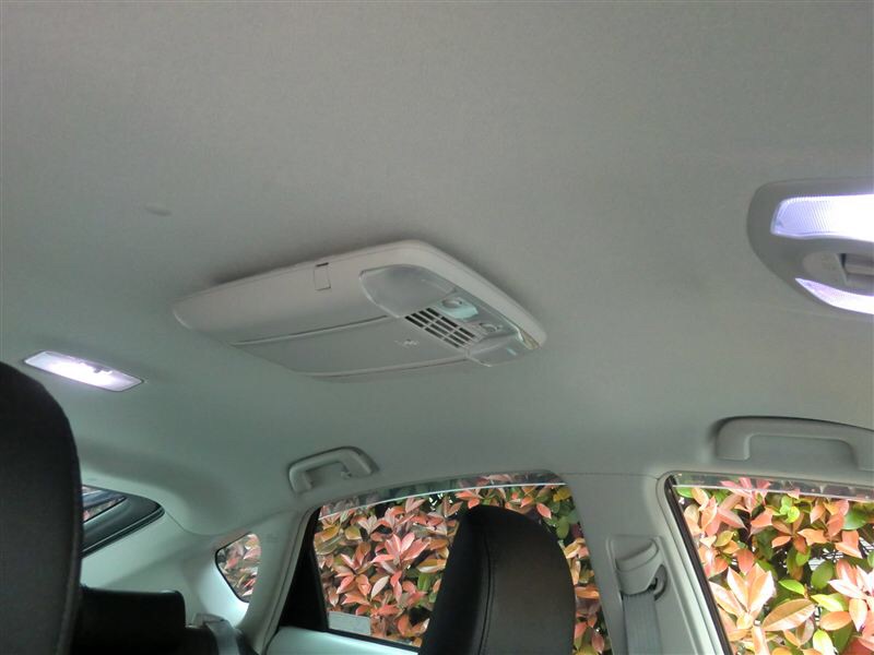

初代目の
This is the one I believe attaches without much issue to the red of the 3rd Gen. There's also a switch made for these you can put in the dash. New they retail for about $200 and are very effective filter systems.
How would this work since the air comes in through the vents? By the time the filter does anything Ive already breathed the air coming from the vents
Correct
These are all secondary systems filtering air already present in the cabin area. So it's not the AC filter but a standalone.
