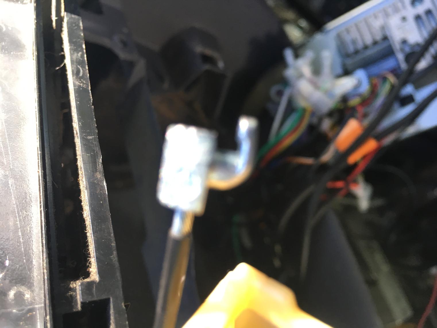

Has anyone replaced one of these? I'm not sure how this is supposed to fit securely without coming apart like mine did. Have the new part about n order, hopefully it will be here in a few days.

Cable won't be here until tomorrow, how should the cable be pulled through the firewall? Cabin through firewall??
So the cable came in today and I'm having a problem figuring how to get the cable end to release. I don't want to break the damn thing.

Sorry I didn't get back to you sooner. Spread the two inner prongs away from the cable end, and slide it out- I believe "out" would be down in the pic.
"Away" being apart from each other.
Thanks, it wouldn't budge with my fingers. I will do that tomboy. I appreciate your help.

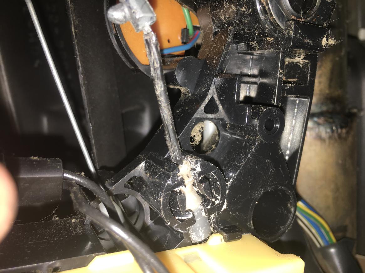

Well I got the cable to release. Now I can't get the head of the cable through the small space. Tempted to just cut the cable head off, but will have the same problem installing the new one. Did you have the same problem? If I could find a way to get this switch part off, it would be no problem.
I know, they're pretty rigid. Unfortunately, they're also probably not hard to break. It's not a super easy task [emoji30]

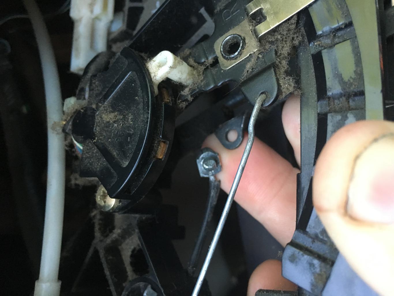

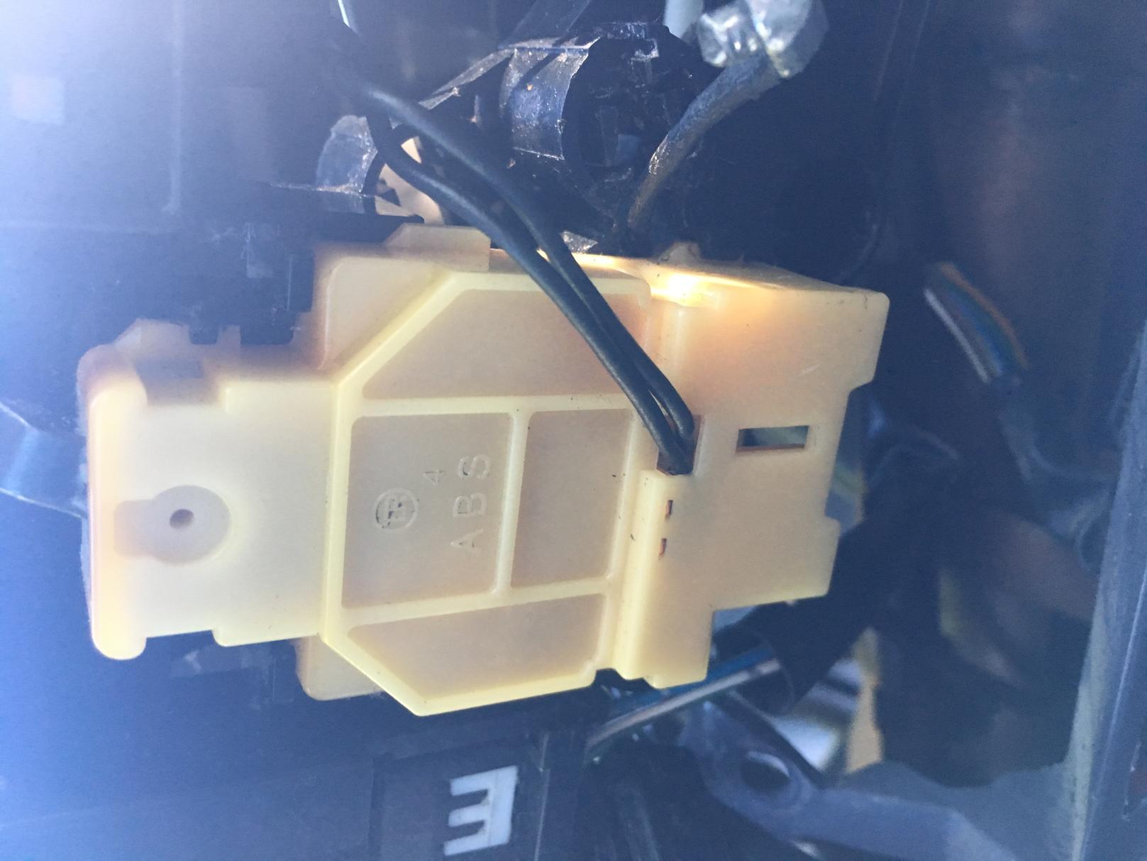

Yeah, the fan switch slides off. I can't remember how, but it's not too tough to get off. Took a little while looking at it from all angles, but I think it has a release, and will then slide off?
Almost there
Got that off and the cable through the fire wall. When hoocking back up does the hook go on top or bottom?

Ok figured that out, but getting to lock in is a real pia. I guess it's time for a break and come back Dan try again
