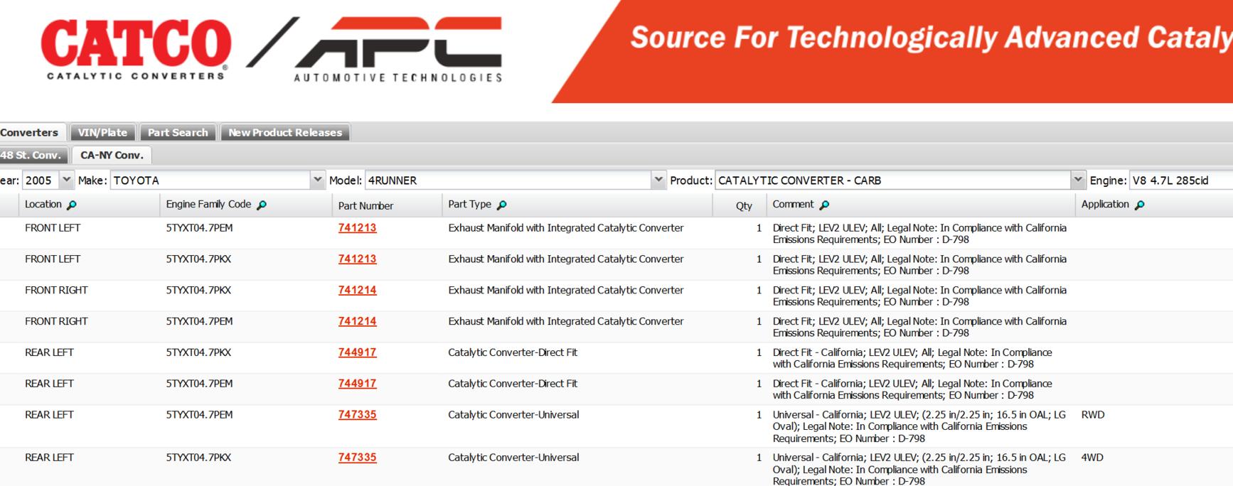

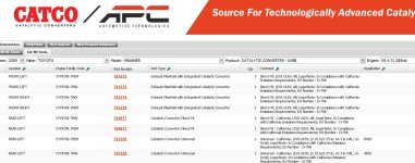

I searched through the ENTIRE B.A.R. exec order lists of every year, the only units that come up for th 05+ vvti v8 motor are the post manifold cats, NOT the integrated manifold cats. But the Catco site does show the actual part in their "pre cat" products page
