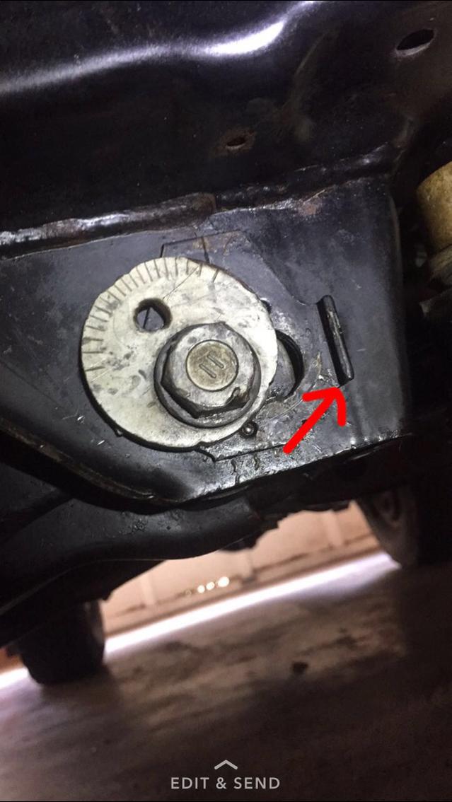

Have no idea what to call this piece but it's completely gone and stripped off on the other side Now the alignment is off and I won't be able to get one.
Question is would I need to weld a piece back to it or is there another easier way?

Those look nice but I'd rather not wait a week and pay $100 for that at the moment. I was looking and can't even figure out how to take off the tab. Could I just buy one somewhere? That would be awesome
You would have to grind them off. I dont think there are replacements. But search more as maybe they can be found.
You would have to grind them off. I dont think there are replacements. You would need to purchase new control arms I believe. But search more as maybe they can be found.
I woundnt think I would have to replace the control arms as the tabs are on the frame and not control arms.. right?
You could just weld a new tab on with some scrap metal. Should be easy enough with the remnants of the old tab as a placement guide.
Should be a ~10 minute job.
