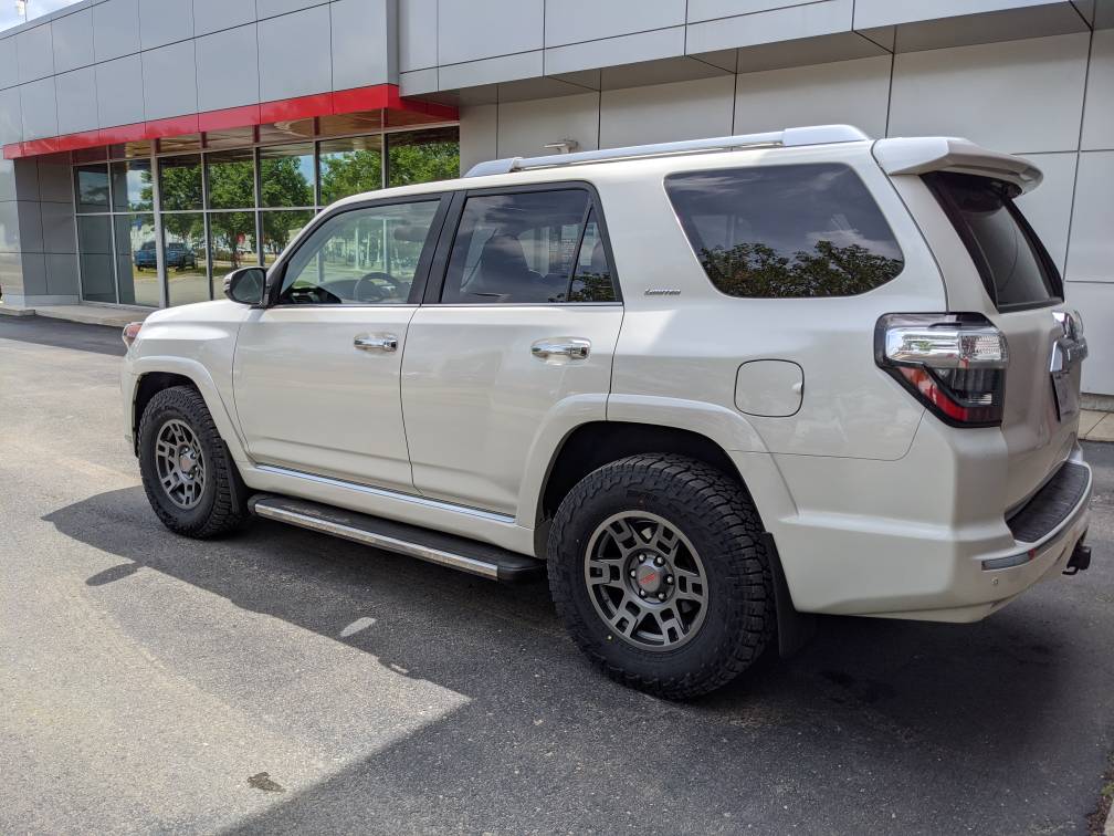

That's literally what I did on mine. Straight swap and added Falken Wildpeaks. Minor rubbing at full lock so I did the fender liner mod and it's all good now. IMG_20200625_121425.jpg

That's literally what I did on mine. Straight swap and added Falken Wildpeaks. Minor rubbing at full lock so I did the fender liner mod and it's all good now.View attachment 365229

If you go with the FN wheels they are 0 offset meaning the wheels are pushed further out than stock. At full lock (turning until the steering wheel stops) you will clip the front lower inner bumper with stock 265/70/17 tires on the LE. As [MENTION=584756]mbm112[/MENTION] stated it's an easy fix and no one will be able to notice it.
Speedo will be fine. The stock 20" and the 17" with stock 265s are practically identical in diameter.

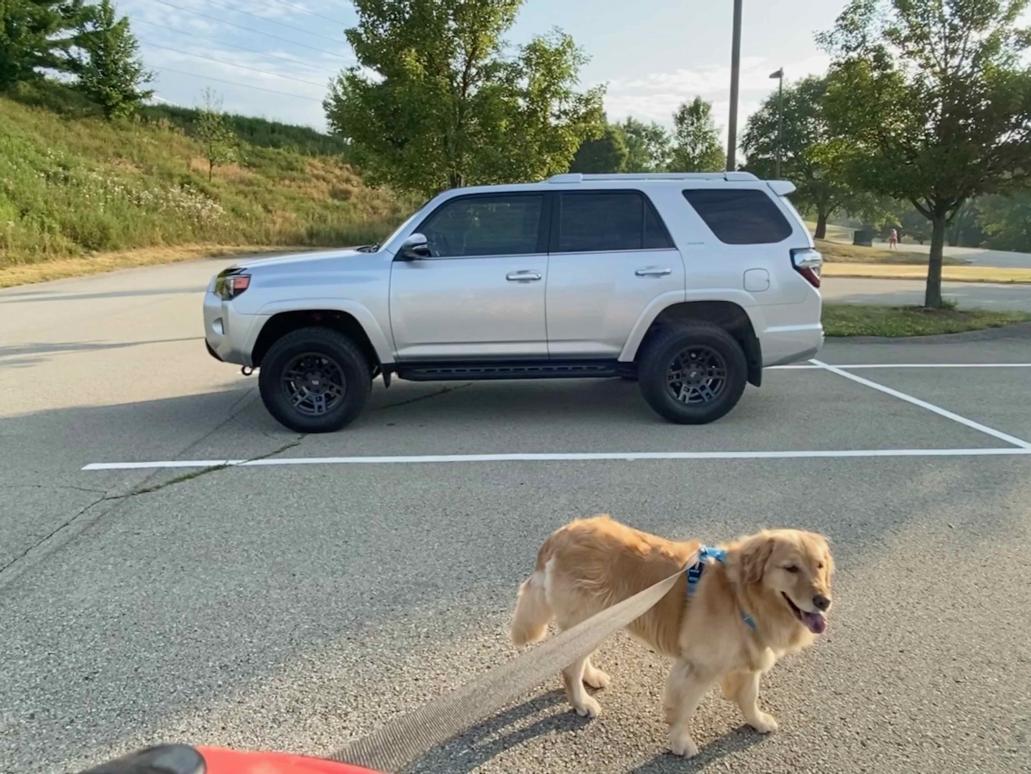

Buy a set if 17s from a member here (especially the OR wheels) and you can frequently get a wheel/tire set for $500 if you're not picky about the tires.
Even if you are, sell the tires to a used shop and you're still coming out ahead.
Alternatively, keep an eye on your local Craigslist as folks do sell take-offs periodically, especially from SR5s and TRD Offroads. You'd probably still want to upgrade tires if you plan on doing offroad driving, but you may easily be able to find a set of take offs for around $500 via this route too.
