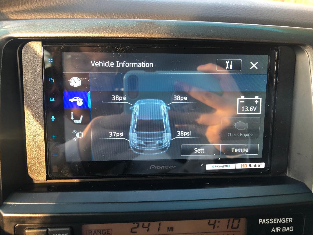

Some of us cool kids use the TPMS data with iDatalink Maestro..
