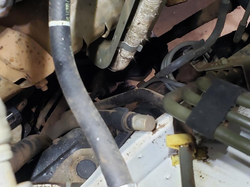

So was looking around the engine bay on my 1997 4x4 today while working on replacing the brake master cylinder and noticed a vacuum line off the left (driver) side of the engine just below the evap box and the brake booster that looks like it has a metal plug stuck into it. I can't quite tell where it runs to - looks like maybe down to the transmission but it goes down by the crossmembers and have a hard time following it... was wondering if this is a normal thing or if someone messed around and capped it off. I looked through the FSM and could not really tell what that line is for. Has anyone seen this?

Front diff breather tube. All normal...

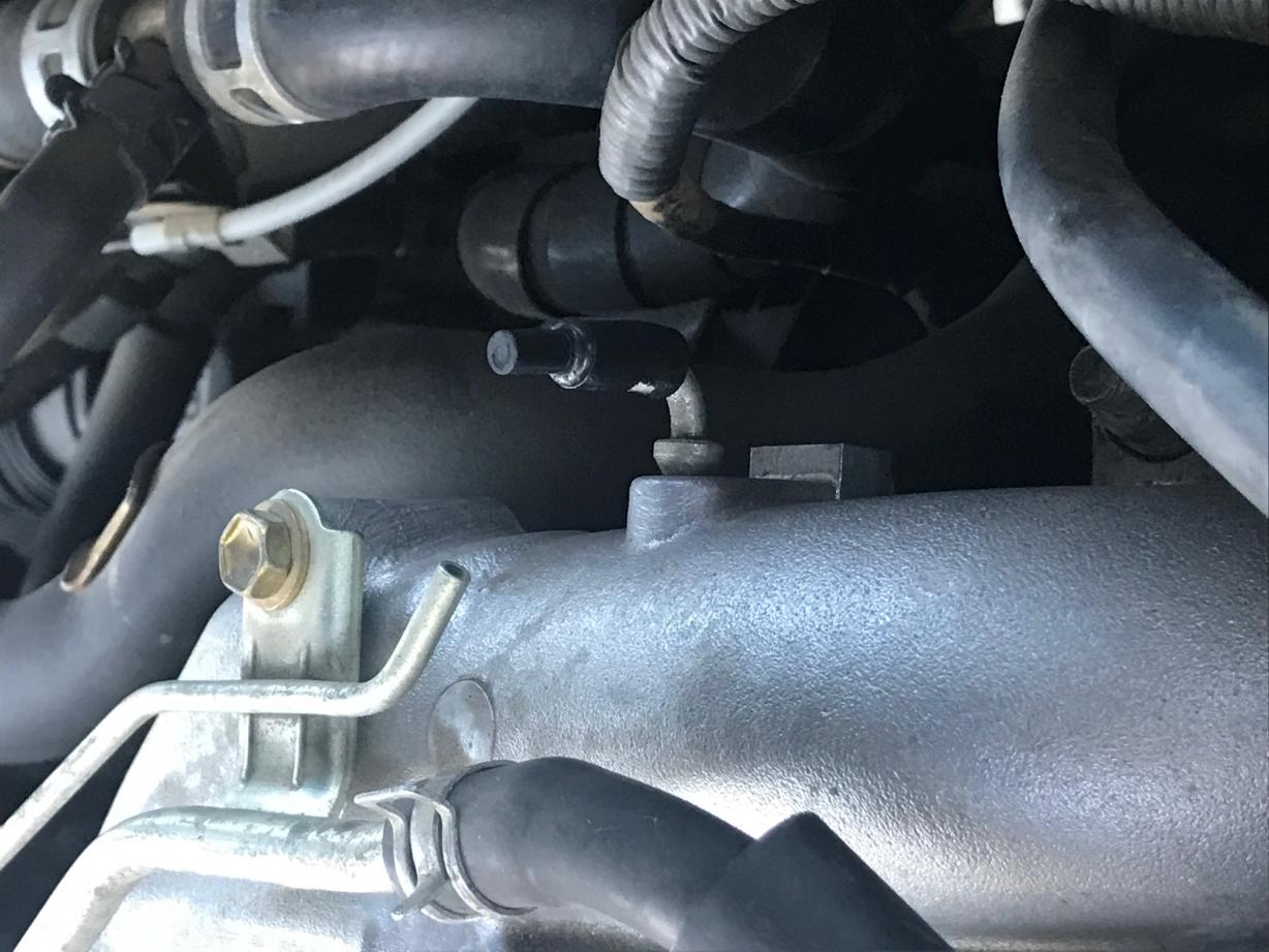

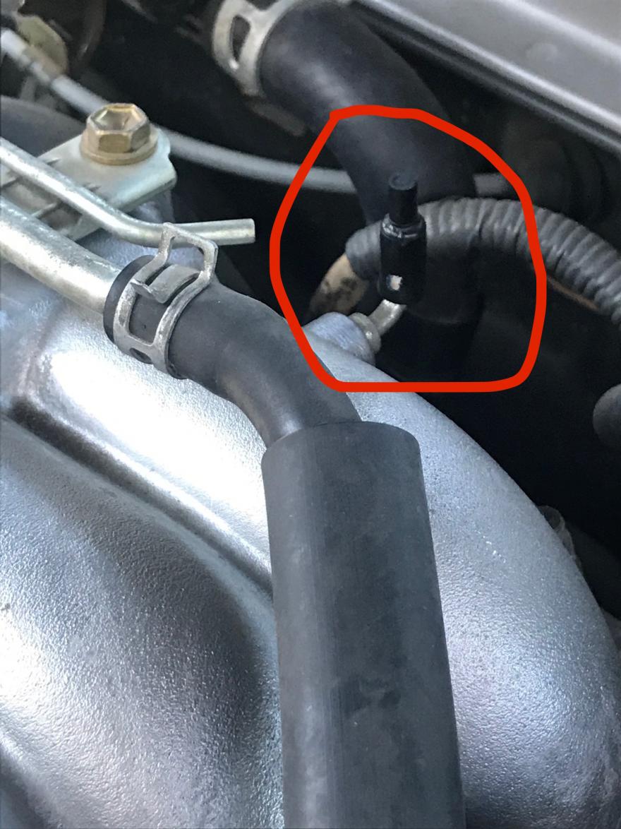

I have a 2002 that I purchased a few months ago. I located what appears to be a capped vacuum port at the back of the intake runners. I was wondering if someone could help identify it and whether or not it should be connected to something. Hopefully, the photos attached properly. Thank you.

That's a factory vacuum cap and is probably correct. Check the sticker on the hood for vacuum routing diagrams. Things changed a bit through the years.

Thank you. I checked the vacuum hose routing diagram on the underside of the hood as well as the maintenance manual that I have and neither show the port that I have. The vehicle has a slightly rough idle while stationary and in gear, otherwise its strong with no issues. I'm just wondering if this should be routed somewhere that would alleviate the rough idle.

On the earlier 4Runners, it does go to the small metal tube there, then over to the throttle body to a throttle opener diaphram - that the 01/02 trucks don't have.
