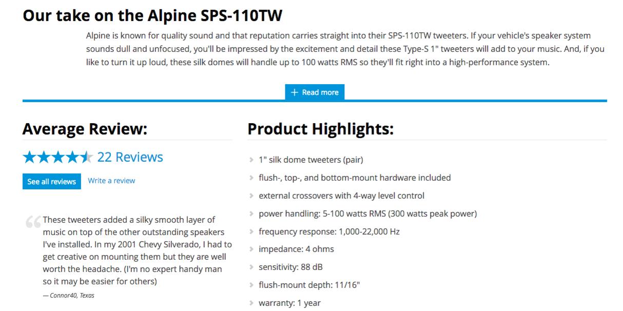

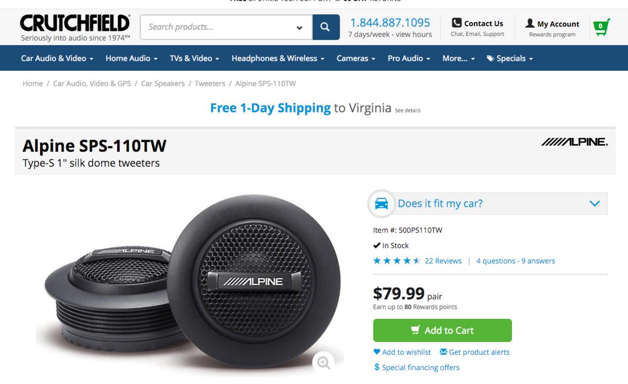

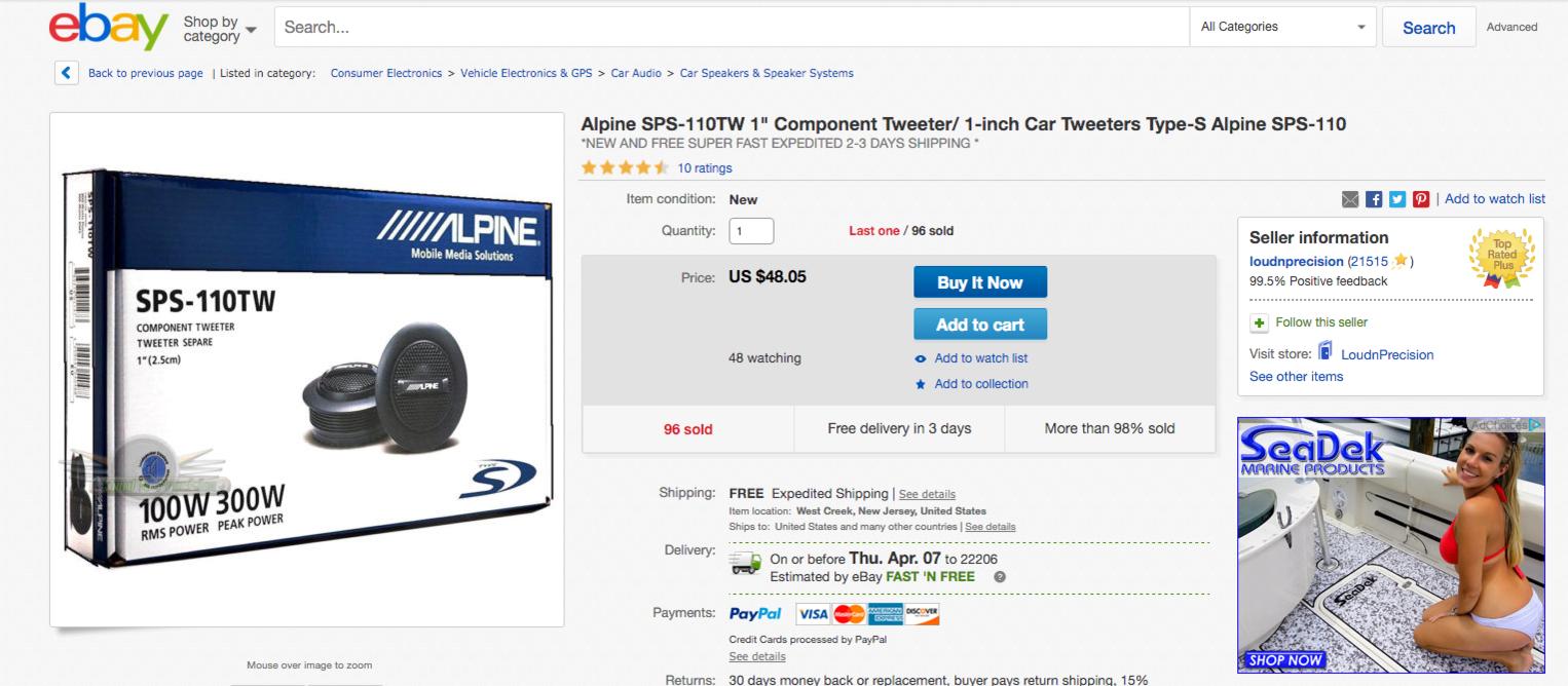

In my current set up (less than ideal but pretty good), I have infinity 6x9 coaxials in the door. The tweeters were too harsh (I think they were made of metal). So I bought these alpine 1" silk dome tweeters for about $50 a pair,
and using the supplied crossover, mounted them in the factory location of the high-mounted door speakers. Then I simply cut the wire in the coaxials that leads to the tweeter part of those speakers. WHAT A DIFFERENCE.
The alpine silk dome tweeters sound great without being harsh or overly bright. I think the silk really helps in keeping the timbre smooth, and the dome shape helps with sound dispersal.
