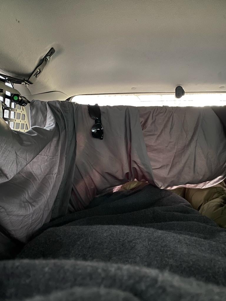

So I built a platform to level the rear out and keep it in al l the time. When we go camping I have an air mattress with some sheets and blankets I use in the rear and I have some battery powered fans I can clip onto my Rago Panels. I also have a jackery for any power needs at night phones tablets heating blankets etc. I had some sheets on bungies for privacy but have since purchased the full set of WeatherTech inserts for the windows. I also got some vent inserts to keep the windows open at night I’ll post some pics when I get those.

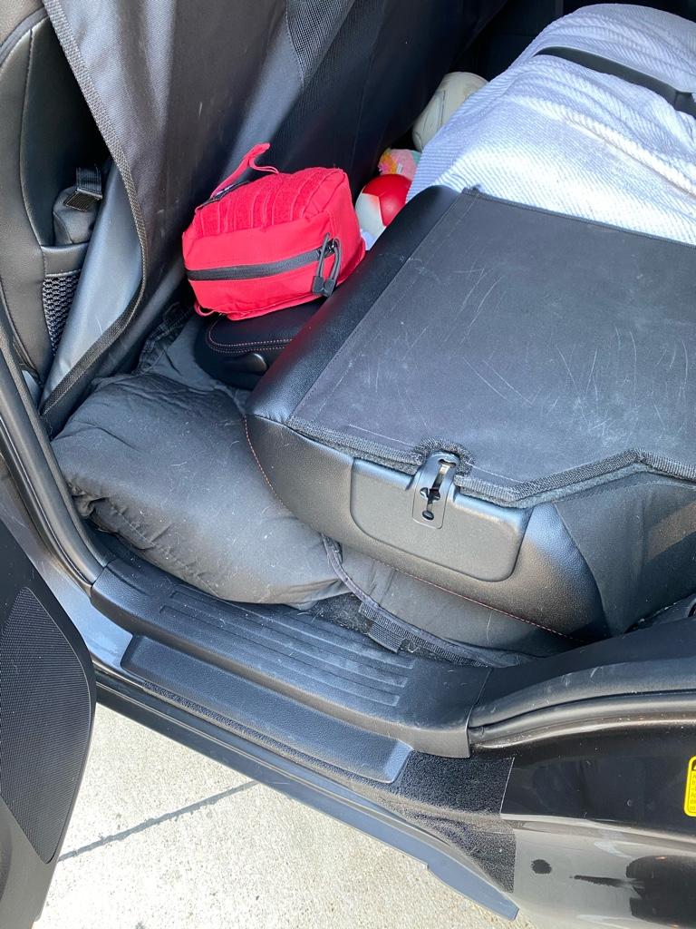

Well did plenty of it stock. Removed the 60 split seat bottom. Cut up iso mats and taped them into layers to form a pad to take up the hump (ugly but functional and cushy). Rubbermaid storage container in the footwell to give me some extra room 6’5”. Pics are floating around somewhere on here.

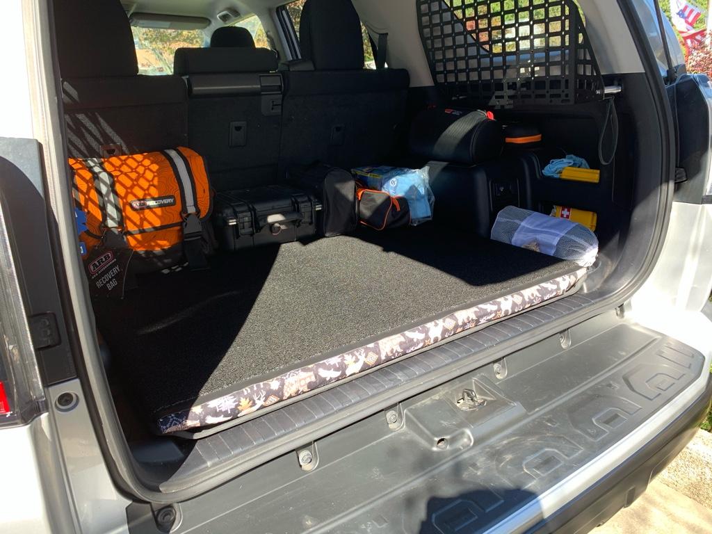

I recently finished my 2nd row delete cargo platform. Will prob just be using my old iso mat with a little inflatable pad till find myself a mattress of my liking.
Looks awesome! What paint or material did you use for the finish?
Looks like a really clean install. Did you apply carpet on top of the platform?
Yes i used a commercial black carpet i cut to fit around the platform and stapled it down underneath, then some cloth to sorta seal off the gap facing out.

I guess it depends on how tall you are. The reason I sleep with my head toward cargo door is because i would rather my feet hang off the mattress than my head. I have the 40% split removed and lay a 72" mattress on the drivers side. I’m 6’1” tall so it’s not perfect but fits in the space pretty well. My feet hang off, but i don’t really care. It’s comfortable. By removing the 40% seat bottom, I'm able to hide my air compressor, recovery gear and tool roll with seat laid down. With it up, it makes it so easy and safe for my dog to jump in and out. I have to keep the 60% bottom so my dog can sit/lay in the back seat.

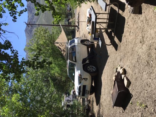

camping solo in 5th gen SR5 daily driver with DIY awning & cot.
I return my 2017 SR5 back to a daily driver after my solo camping outings, so everything comes out.

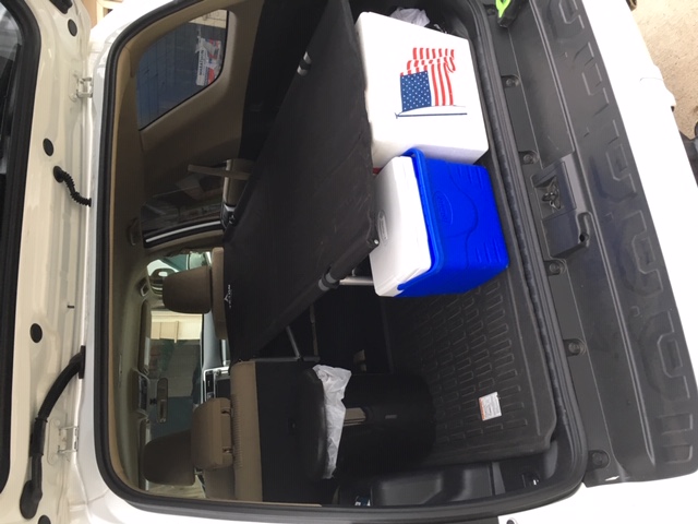

The Teton cot has 2 pair of legs, and I can level the cot with small blocks of wood if the car is not level.

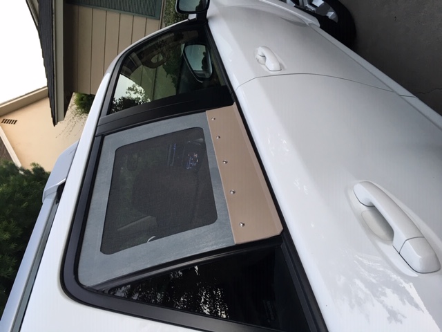

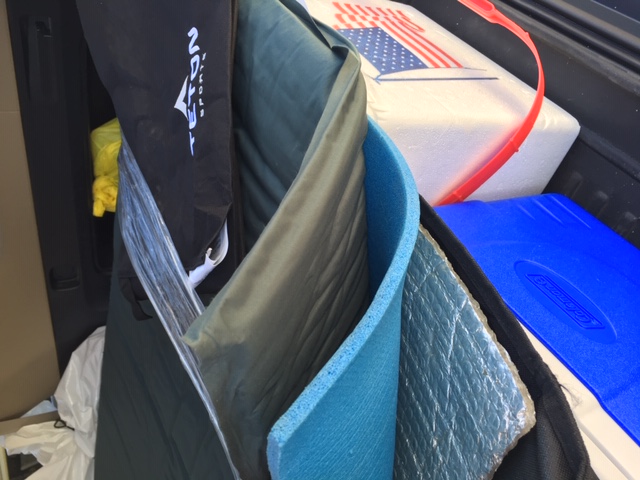

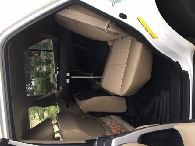

I sleep with my head beside the rear side door windows and I have DIY screens on both doors for cross ventilation. This cot fits snugly over the folded passenger side rear seat giving a 28" x 74" flat bed. For cold weather I have 3 layers of pads on the cot: Mylar insulation (Home Depot), closed cell ground pad, self inflating air mattress. Space under cot works for small coolers and boxes with supplies.
By having the driver side rear seat set up I use it in camp and easily roll onto the cot feet to rear.

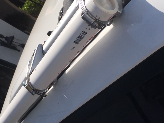

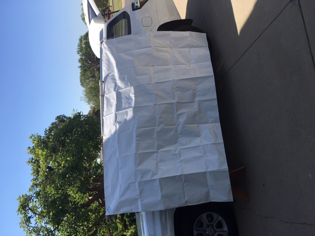

My DIY awning works great. A Bushpro Silvicool tarp 6'x9' stops the sun's heat, and rain. My 9-1/2' DIY awning roof poles are quick & easy to attach and remove. The 72" Lathi wood staff comes out for driving but the 36" PVC stays on till heading home.

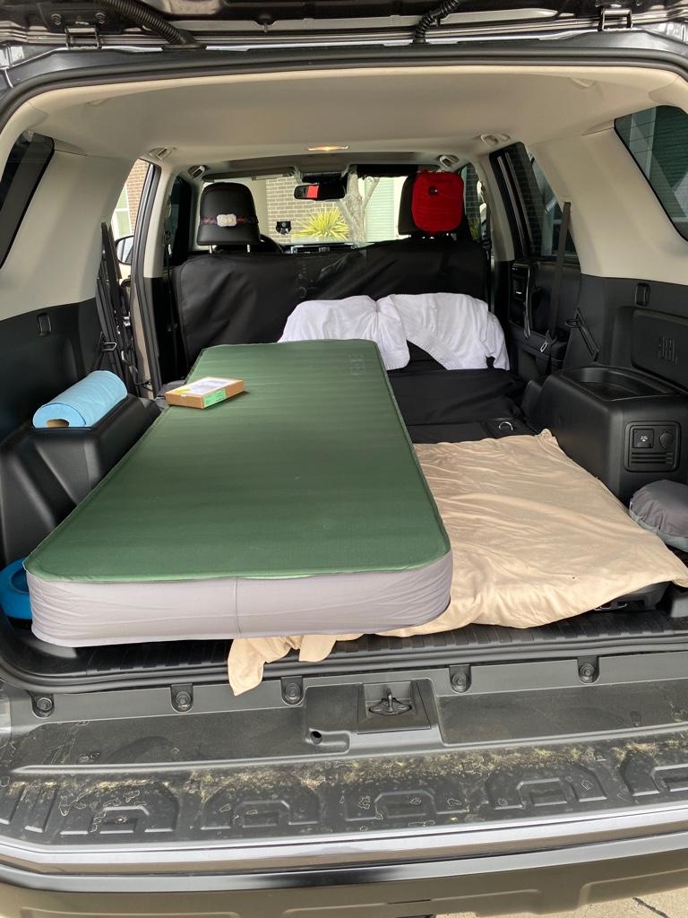

I've got a built-in stealthy cargo box that levels out the cargo with the rear seats, similar to [MENTION=65614]Antman[/MENTION]'s original build. On top of that, I run a 31" wide trifold mattress (honestly the same one I sleep on nightly in the house):
Amazon.com: Milliard Tri Folding Mattress with Washable Cover, Cot Size (75 inches x 31 inches x 4 inches): Kitchen & Dining
On top of that, a 39" wide 40ºF Coleman sleeping bag:
Amazon.com : Coleman Autumn Glen 40 Degree Big & Tall Sleeping Bag : Sports & Outdoors
It's a wide sleeping setup and has the advantage of being able to sit up straight without my head bumping the roof. I prop a couple of pillows against the passenger seat and can hang out and read or work on the laptop just fine.
