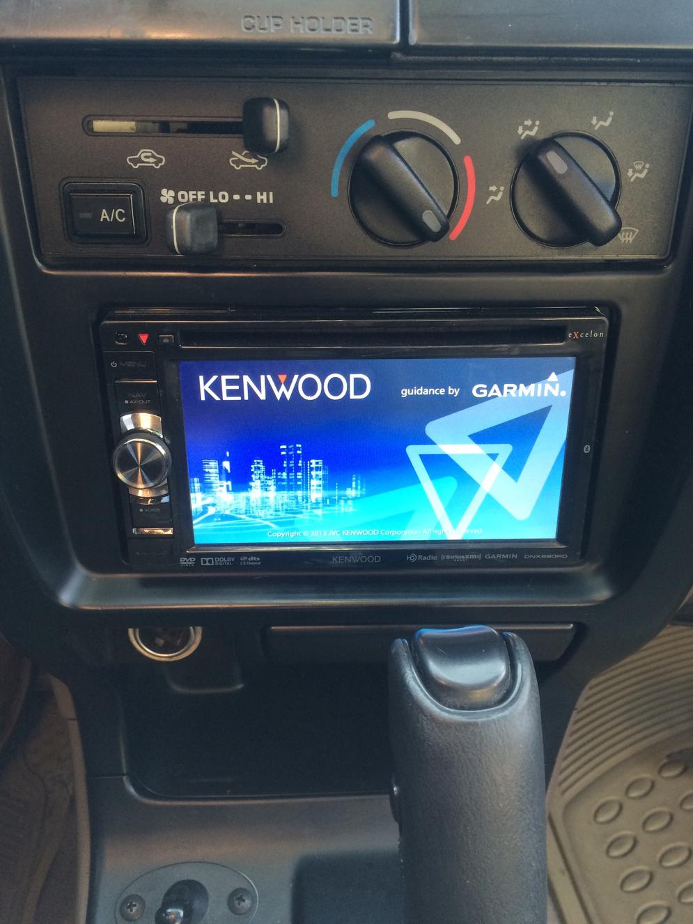

Sometimes places like cartoys or drive-in auto sound have good deals. I got a refurbished kenwood for $375 with a free two year warranty. It has nav, bluetooth, hd radio, back up camera, DVD/CD, USB, and is satellite radio ready.
No dash kit needed since it's double din. You can just buy a toyota wiring harness from Walmart or autozone in the stereo section. Then you just splice the wires which are color coordinated and plug it in.

I run a Kenwood kiva bt901 and while it's old....it's awesome. Has all of your needs built in but doesn't have a cd player. Great sound quality and a huge amount of tuning ability should you add amplifiers.
Also it's available on prime. I paid almost 400? It's 184 bucks now.
Kenwood KIV-701 iPod/iPhone Digital Media Receiver https://www.amazon.com/dp/B0051FNXUS/ref=cm_sw_r_awd_WQkRub15004KH
I have a pic of it installed on my build thread...should be in the first page.
