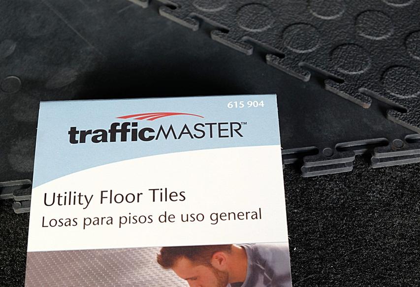

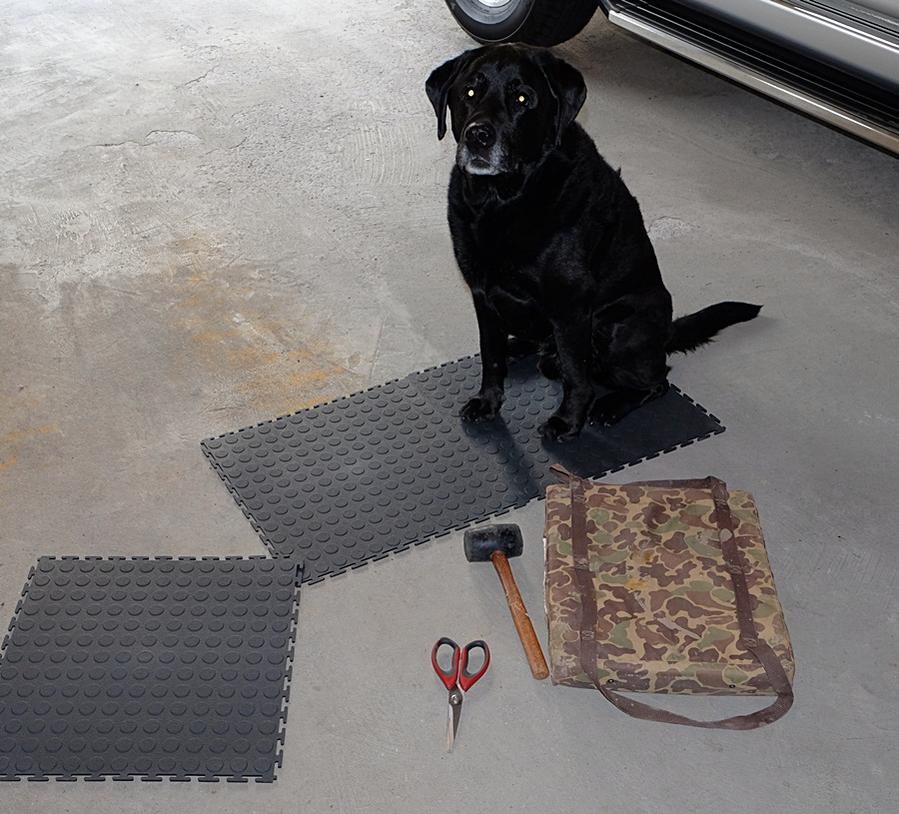

The tiles have a nice, rubbery texture for dog traction, and so loose objects don't slide around. Also, the tiles are very dense. There is no way a dog's toenail would cut this stuff. I bought a package of 6 tiles, each is 18" x 18". I found them at Home Depot. $23. Here is Diesel taking a trial sit down.

Those shears in the picture above are only for nipping off the leftover "ears" on finished ends. For the real cutting of the tile, use a brand new utility knife blade.

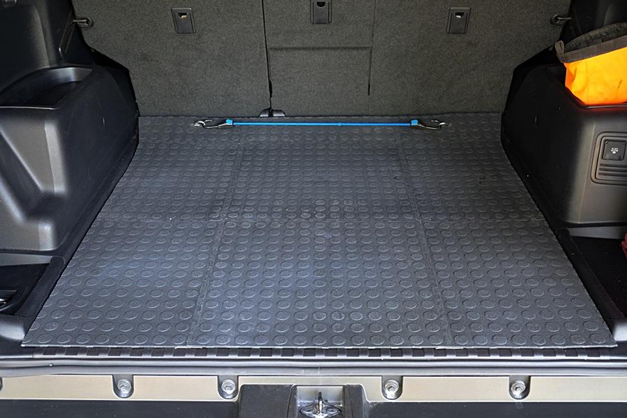

The tiles snap together with the assistance of a rubber mallet. After curring my shape out and test fitting it, I flipped it over on the garage floor and applied Gorilla tape on all the seams. I cleaned the seams with rubbing alcohol first, and heated the tiles with a heat gun for a good tape seal. It is rock solid. If you wanted to go to the next step, you could add a bead of RTV to the tile seam, then put the Gorilla tape on. I didn't think that was necessary.
Here is the finished mat installed.

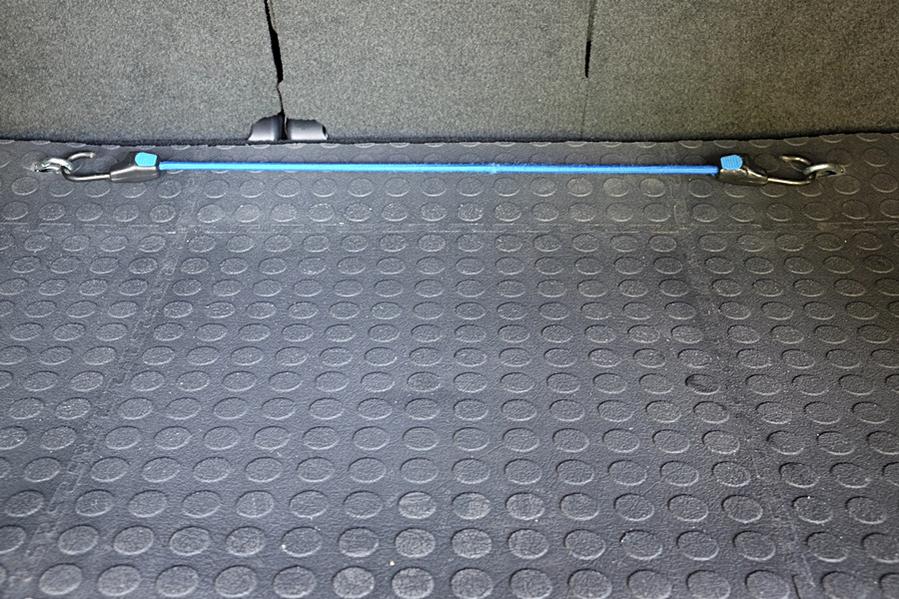

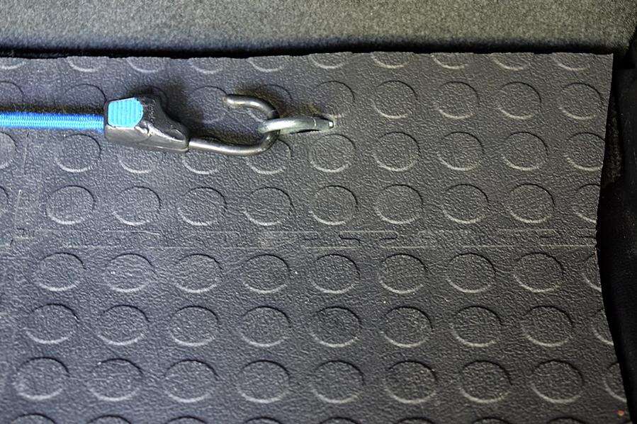

I added two Quick CLips, one to each of the front cargo tie downs. Then, I carefully cut two slots in the cargo liner, threaded the clips through, and ran a bungee between the clips. Now, the mat is secured in place, I have a handy bungee ready to use, and the cargo tie down points remain fully functional. Clip detail pics..........

Took me a couple of hours overall. Straightforward and fun little project. You could flare the ends out at the rear to cover the floorspace betwen the back of the rear wheelwells and the liftgate, but I didn't because that area is already plastic, weatherproofed, and indented to hold loose stuff. Also, the cargo liner is plenty heavy eough to stay put, so I didn't think I had to "index" it over the rear cargo attachment points to hold it in place like I did at the front. Might be a good idea for someone with different needs, though.
