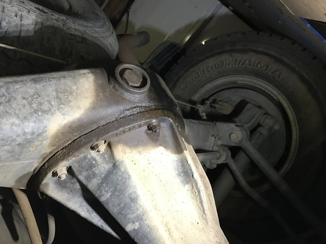

I am assuming that the carrier gasket it bad. Can anyone back me up on this.

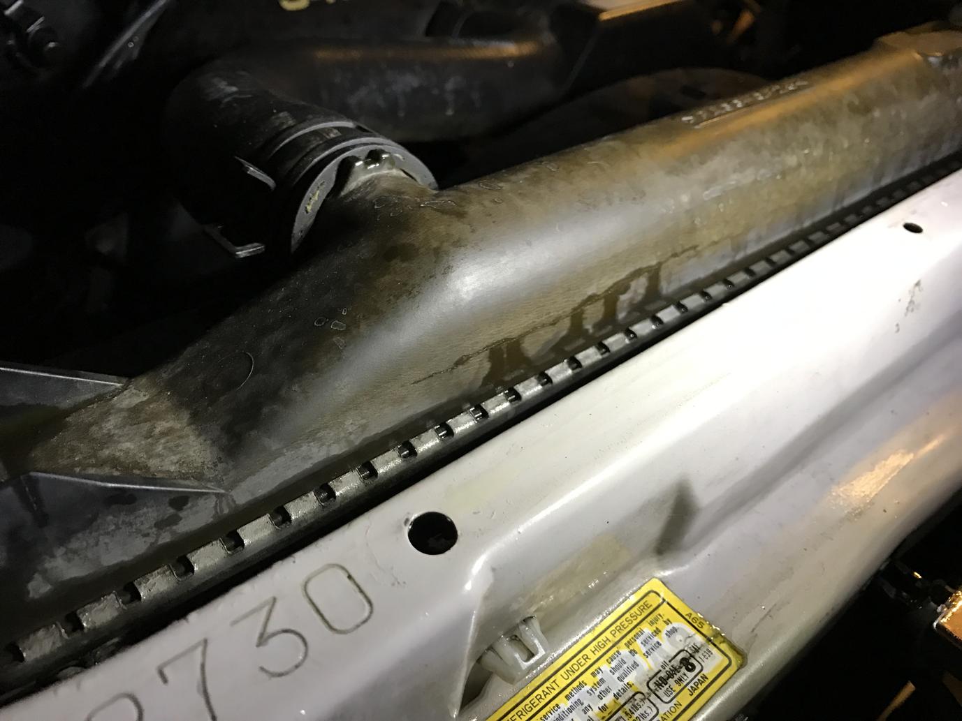

Also should I fix a radiator crack with epoxy or replace the whole radiator?

I would not touch the rear end gasket. That is not even what I would consider weeping. Ill go with it is sweating only on Tuesdays. If it really bothers you spend the time and money to replace it. If you are going to replace it dump some Lucas in first. If it works you golden if not your changing it anyway.
Yes buy a new radiator....1hr and a $100 bucks. That thing is shot...I will post a pick of what is about to happen to it tomorrow.

Yeah the rear end drops a lot of oil on the garage floor. I can do all the work myself I was thinking of pulling it out and putting some rtv on there.
Roger that on the radiator plus I will switch Toyota red

Change that radiator ASAP. You don't want to find out what happens when that little leak turns into a big hole once the pressure builds up.
Spoiler: It involves lots of steam and a tow home.
