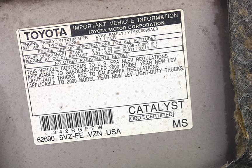

So after reading thru the threads I have determined I have Cali emissions 4runner by the sticker under the hood. This means I have 2 cats,

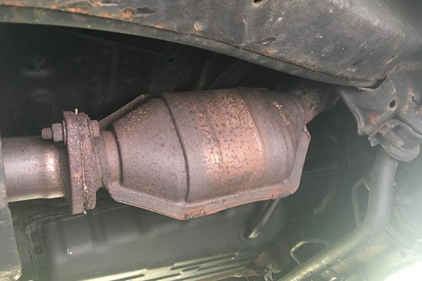

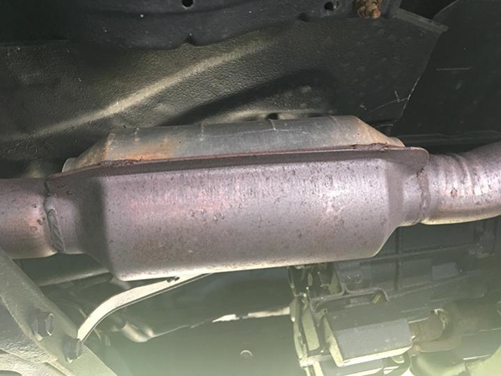

see pics below,

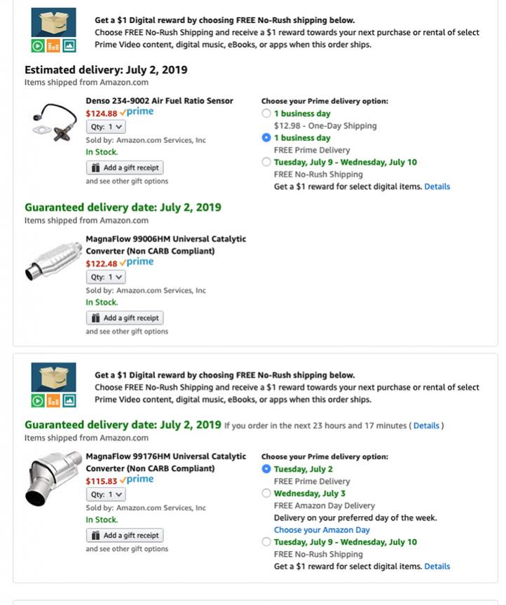

Want to buy these parts as a pre emptive strike so repair can be quick.
I realize the front and rear cat shown is not direct fit, welding required, that may or may not be an option. Searching now for a direct fit Front with flange
I know it may be just a exhaust leak, but the rattle has me thinking not,
I'll return what I don't need if any.
Am I on the right track ? Thanx for any info ..

Well, on these trucks it is very common for a P0420 to be caused by exhaust leaks. If the system is factory, the gaskets have pretty much turned to dust. So I would carefully check for any exhaust leak from the downstream sensor back. A new gasket and nuts/bolts costs a lot less than new cats (which may fix the problem, because you will put on new gaskets where they meet the pipes, and you will never know how you wasted money.)
I am still running factory Cali. cats on my '99, but I had to do the gaskets which also meant nuts/bolts.
I see your in california. Just so you realize those both say non carb compliant. Carbs (California air resource board). Not sure if they will catch that or not but just a heads up.
Also higher octane does nothing for our vehicles. All it does is mean if your running a suer charger or higher compression it wont pre-explode before the spark. Dont waste your money on higher than 87. It has no benefit.
Where does he say he is in CA? Profile says SE PA.
Thanx, Held off on the parts order. The front cat looks to be original and the gaskets are def worn. Will start the trouble shooting there.
Thing that is throwing me off is the rattle stopped. Went under the truck, everything is tight. exhaust , muffler etc.

Look at the rear tail pipe section. When an exhaust hanger rusts off that tail pipe section lays on the frame

Well, it could have been the heat shield on the outside of the cat which is no longer there. If it never comes back, that was probably its last gasp before falling off. Mine fell off a long time ago. If it was the ceramic matrix inside the cat, that's usually fatal for that cat. Here is one with the heat shield:
There is a difference between sheet metal rattling from the cats and pipe against the frame noise which is a lower pitch, almost a rumble, not tinny like the other noise.

Whole exhaust system from the manifold to the tailpipe was original. Muffler was shot, tailpipe was shot, front cat was shot. At this point I replaced the whole system to avoid any issues down the road in case the rear cat decided to go. Prevenitive, only added a couple hundred to the fix.
Went to Rock Auto ordered direct fit front and rear cat CARB compliant, and full muffler/pipe etc kit.
Went with Eastern. Got the 2 Denso O2 sensors as well. $875 and change delivered.
Had to drill out the exhaust manifold bolts as expected, but the whole thing went right in and fits like a glove.
