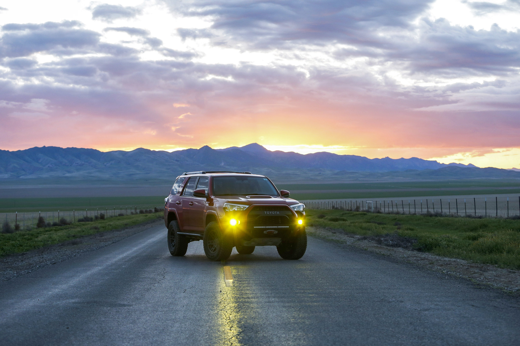

With the bumper alone you're looking at probably 60lbs. I think that's what CBI said their aluminum bumpers weighed? Then if you are adding a winch you have to throw on another 60lbs minimum, more likely it'll be closer to 80lbs, but it can vary. Light bar and fogs add weight, but nothing that'll make that big of a difference.
Keep in mind if you have rock sliders, skid plates, roof racks, roof top tents, etc, these all will play a roll with the front suspension as well.
I have a '17 so I'm not sure how well they compare to the fox shocks and what the Fox ones can handle, but with the 2" TRD Pro Lift from Toytec for the Bilsteins, I still had a good amount of sag. Had I not had the 2" spacers (which is what the lift really is) it would have sat lower than stock no doubt in my mind.
Posted a photo to give you an idea below.
As far as fogs, yes you'll want the circle style ones. Their official name is the Squadron. Those are what fit perfectly in the CBI style cutouts. Same with C4 and others.
I don't think you need a new suspension, especially when you can adjust compression, but you might want to find the same size coil in a stiffer form to help with the weight. With what you're doing a 600lb should work fine. Assuming that can be done on those shocks.

I ordered the BD Squadrons but the SAE (road legal) ones. I ordered the 4 runner kit because another forum member said you need the brackets in the kit to fit the fogs to the CBI bumper. I have sliders and a roof rack but no armour. I have a goose gear system which is a fair amount of weight in the rear so hopefully adding some to the front will level it out.
The shop told me to expect some sag. I know the fox TRD pro suspension is 1” higher at the front. But I also have dual battery and compressor under the hood. I’m sure it will sit fine for road driving. I don’t have anything too crazy planned off-road trails his year. Once I decide on a rear bumper I’ll upgrade the suspension and o something with a lift and stiffer shocks.
Thanks for the picture your rig looks awesome.
Interesting about needing the brackets. Would have thought the standard brackets that come with the Baja's would work, but I guess CBI could have had a different mounting setup. I have a full C4 bumper now and theirs have a hole spot at the top to run the standard brackets.
At long as you got it figured out that's what matters most.
Yes, with all your added weight you'll likely see some sag. Of course the easiest option is to put it on and see if it's too bad you can't handle it or not, then upgrade or upgrade coils. As mentioned before not sure if that can or can't be done, but worth looking into before dropping big money.
But I can say if you plan to do off-roading, an off-road suspension setup makes night and day difference.
