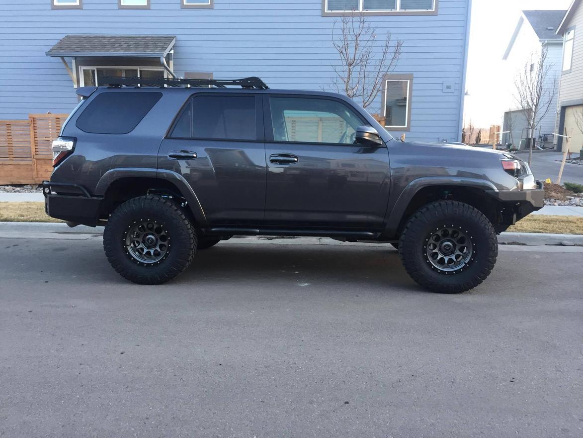

Thanks for the input guys, I am thinking I'm going to pull the trigger. I just hate buying stuff like this without ever seeing it in person. I have OME medium duty springs front and rear so hopefully they will handle the weight of the bumper well. I'm also going to keep the factory spare, I think it will be good enough. Besides the extra weight of the tire carrier I just don't think it's completely necessary for my needs. I really just want the extra protection so I don't damage my stock bumper any more then I already have. Also, thinking I should re route tail pipe because that always seems to scrape. Here's my ride, this is from last weekend at AAOA
