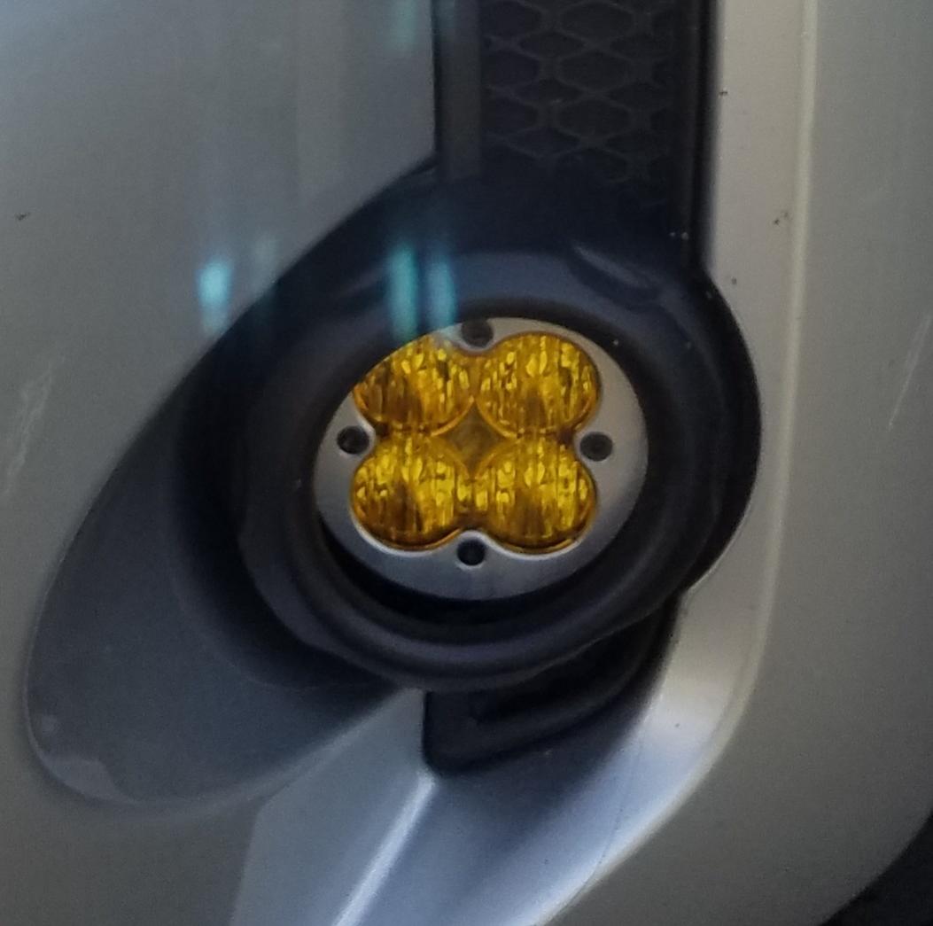

[MENTION=511809]JRod0981[/MENTION] I had the Baja Design kit back before it included the angled face plate. With the flat face plate you might have enough room to change the lens without removing the fog lights or bumper. It would mean working from both the front and from underneath the bumper but I think it would be possible. You might also consider trying their amber rock guard to fit over top of the flat bezel. But I'm not sure if that would work as easily.
As for how to get it, you'd have to order directly from Baja Designs and request the flat bezel. If there's a comment or request section online you could use that, or just call them directly. Don't forget they offer 10% off and $5 contiguous US shipping with discount code BDFORUMS. I would suggest the black face plates.
This isn't the best angle, but one of the shots I have showing how much gap there is between the OEM bezel and the flat face plates. That gap was almost the same top and bottom, your pinch point would be on the outside edge, and that still had some clearance.

Eh I’ve replaced the lens on mine without removing them from the 4Runner . You can pop off the black trim on the bumper. It takes a bit more work but it’s doable.
