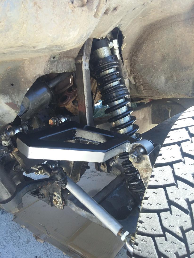

As college students who wanted LT [MENTION=89531]Cartzo[/MENTION] and I made our own.
OP you can run a blazeland kit though which modifies your stock arms, it costs like a grand I think.
Mine, hopefully Cartzo will post his which looks way more sick.

[MENTION=92884]snivilous[/MENTION]
On a side note, have you gusseted the spindle since the above picture? I know they usually don't have issues, but I've seen a handful of 4Runner, FJ, Tacoma spindles get tweaked at that thin portion on the top.
Not yet, my previous spindles were gusseted and I just haven't had time to get around to it. It's in the maintenance/modding queue.

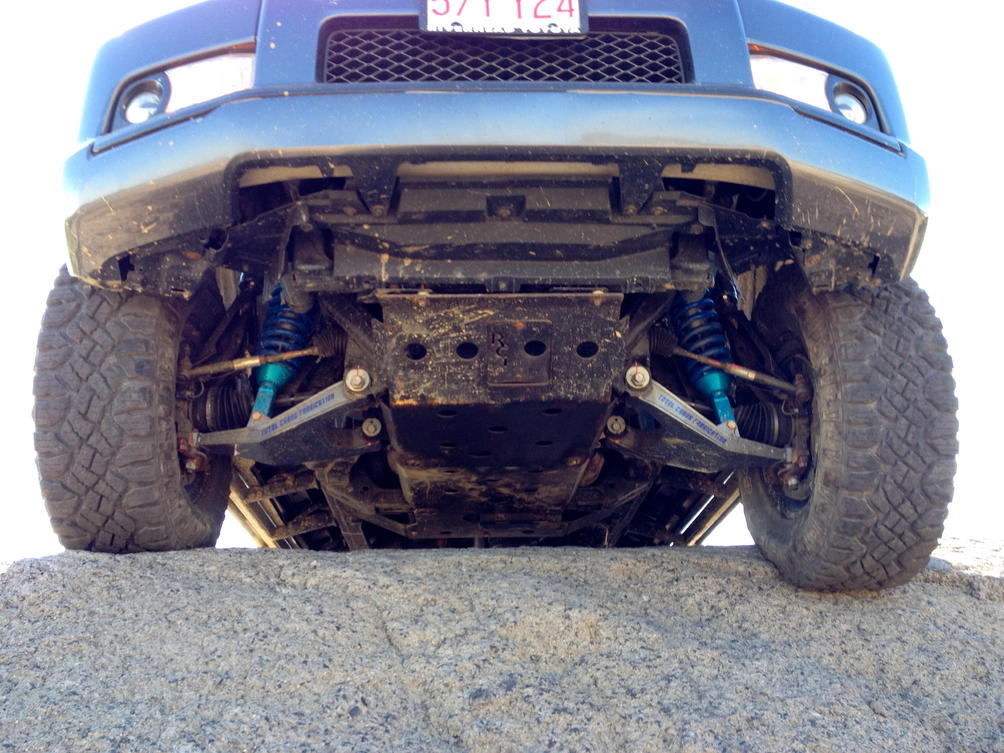

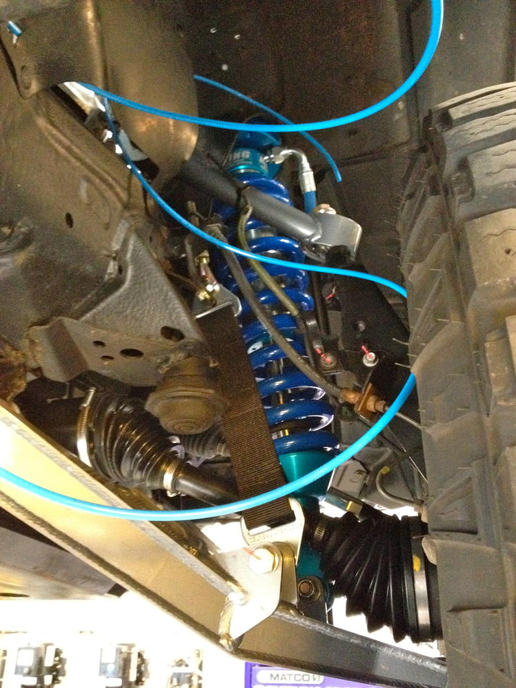

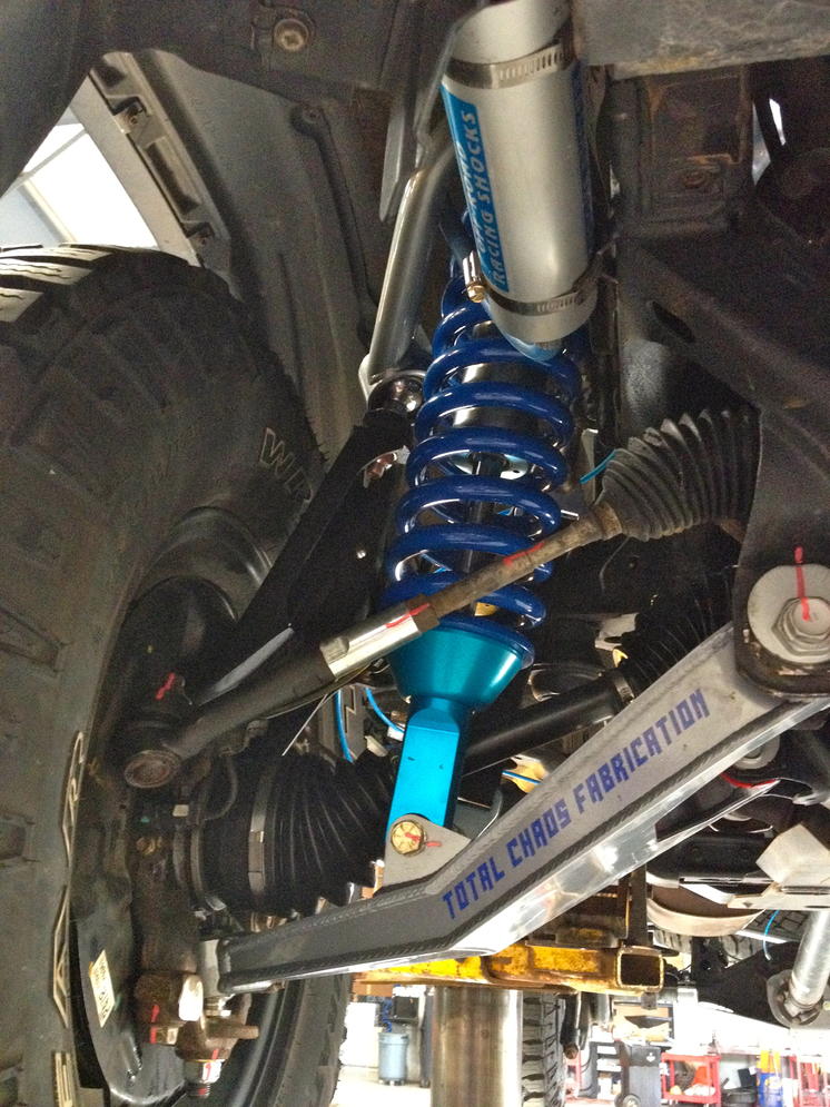

Although not cheap, this is the kit that I'm running. Total Chaos +2" Race Version with Kings.

other than putting on that did you do anything else to the front suspension?
nope - bolted on all the parts that come with the kit including the extended brake lines, I already had upgraded t-bars (Old Man Emu) and had the OME steering stabilizer. Then the guy I got it from gave me the T-100 CV's & Bilstein shocks. I eventually added some Energy Suspension extended bump-stops then 2" wheel spacers in the rear and got a idler arm brace from Blazeland. Everything else is stock - I tear down the entire font end and replace everything once a year: upper/lower ball joints, inner/outer tie rods, pitman arm, idler arm - Thank you Autozone for lifetime replacement and Firestone for lifetime alignment.
