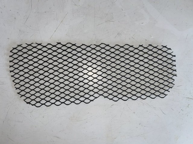

Whatever repellent measures you try, first install a mesh screen (0.25 in grid or less) over the air intake. It’s an irregular shape. See photo below. Glue it down with a strong flexible adhesive.

What do you mean by the HVAC filter? The cabin air filter in the glovebox? I pulled it just to check, but do not see anyway for mice to get into it. I assume the intake is under the grill under the windshield wipers?
That’s correct.
Thank you. However, again, I cannot see any way for mice to get into the duct and nest atop the filter media, either from the outside (the grill openings under the wipers are too narrow for entry) or under the hood. Let alone a place to place the screen shown above. Were there changes in the ductwork of the 5th generation somewhere in the years? I have an '18.
Mice can get through an incredibly small gap, as little as 1/8". Stop thinking in man size terms; there are numerous places for the mice to get in.
That is why screens seldom work. Better to use mouse repellent such as peppermint oil or moth balls.
