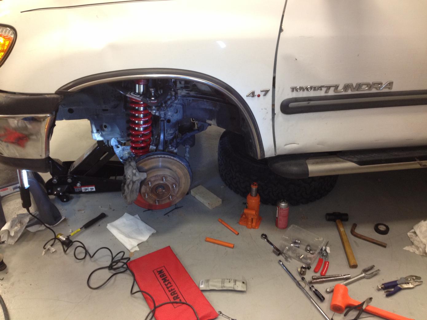

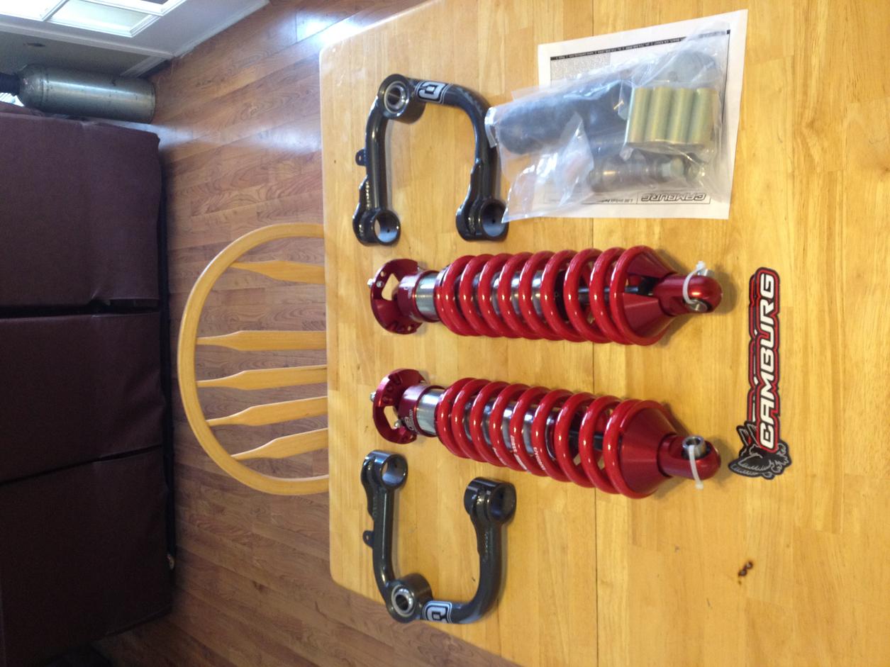

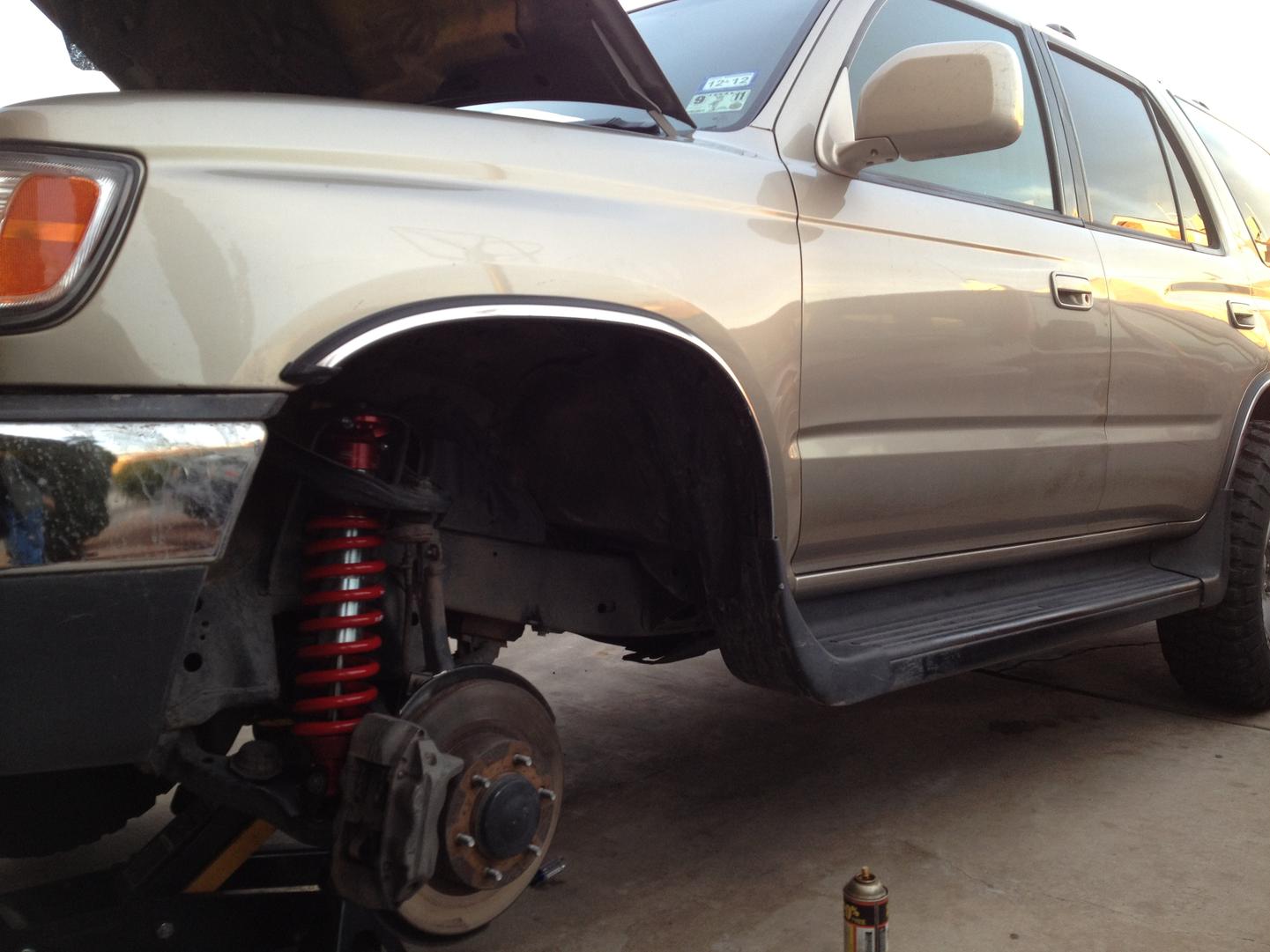

I just put these coil overs on my 4runner i took them off my tundra they handle the whoops way better on the 4runner then the tundra the pic of the kit with the a arms thats for the tundra. I just now need to find some suspension for the rear the rear cant keep up i got the back tires like a foot off the ground threw the whoops maybe higher. any suggestions on leaf springs and shocks?
O.P. You don't have leaf springs on the 4Runner.....they are coil springs.....
If you have not already, check out the Lift FAQ at the top of the 3rd Gen forum page. There is a ton of info in that thread regarding lift options.
That being said, I'm Running Landcruiser 8 Wrap coils, and some Skyjacker lift shocks (not ideal, as they are made for a 2.5" of lift, and the springs yield more), in the back. The truck rides pretty nice with that combo though.
Depending on how much lift those front coilovers give you, meaning if they give you more than the stock Tundra coils and struts, I'd run the Landcruiser 9 wraps with some stock Landcruiser shocks. That should give you some suspension rake, and allow you to tow or load the truck up with gear, and not have the rear sag down.
Again, this is just some of the info available in the FAQ, so take a read at that first, and then decide what you want to do.
Your quest, starts here:
http://www.toyota-4runner.org/3rd-gen-t4rs/66976-3rd-gen-4runner-lift-information-faqs.html
You'll want something with a higher spring rate. I'd go with the OME 891's in the rear and either OME shocks or the 5100 Bilsteins. Icon makes rear shocks but they are pricey and probably best for the desert.
I'm happy with Icon's in the front and OME setup in the rear though for now.
lol.... y'all are so mean on here.
I am running the same set up up front. To level out my rig, I had to throw some 1.5in daystar spacers under there even after getting my old man emu 890 in. I think that they must spec those springs off 01' or 02' stock springs, b/c they are definitely not 3in taller. When I stood them next to my stock springs from my 98', they were only about 3/4 of an inch taller, hence needing the spacer.
The other route would be to go with some LC springs (7-8 wrap), but I keep hearing that they are really mushy.
I wouldn't go with the 891 unless you are planning on really having 500lbs of cargo in your rear, 890 are the 'goldie locks' springs in my opinion for wheeling... that is unless you do have 500lbs in the back.
And for shocks, just buy some cheap ProComp 9000. You are just wasting money if you buy those fancy Fox shocks that are $150, you only need those if you're hitting 10ft gaps out in the desert at 80mph...
you can always get rid of the gay stock mounting point, and weld a stud on the frame, that way you can use hoop to hoop shocks like NORMAL trucks lol
Check out City_Rider's 4Runner on here too. He has Fox. 2.5's and UCA's up front and fox resi's in the rear with a similar shock setup as "chaplain" on ttora.
I have the Camburg setup also. I have their UCAs. The coilovers KICKASS!! I'm running the Bilistein 5100 the rear, along with Tundra springs. My rear end is level with the front, but I think I'll be changing over to Icon very soon.
