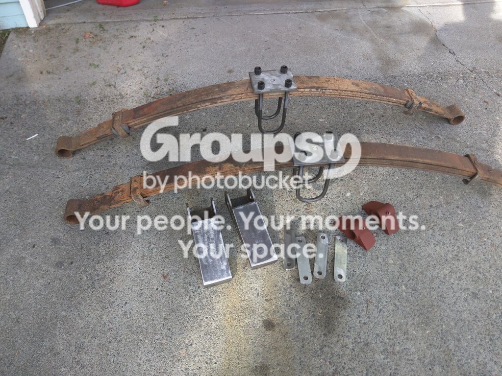

Here's what I've made so far ended up making 5" shackles can make more different sizes later on if I have to

That's really all up to you, no 63 setup is the same as any other. They're all custom fab and they're all different.
I know that was just looking for a couple of tips to get going in the right direction I guess we'll see what I have to do when the time comes and I start cutting away
