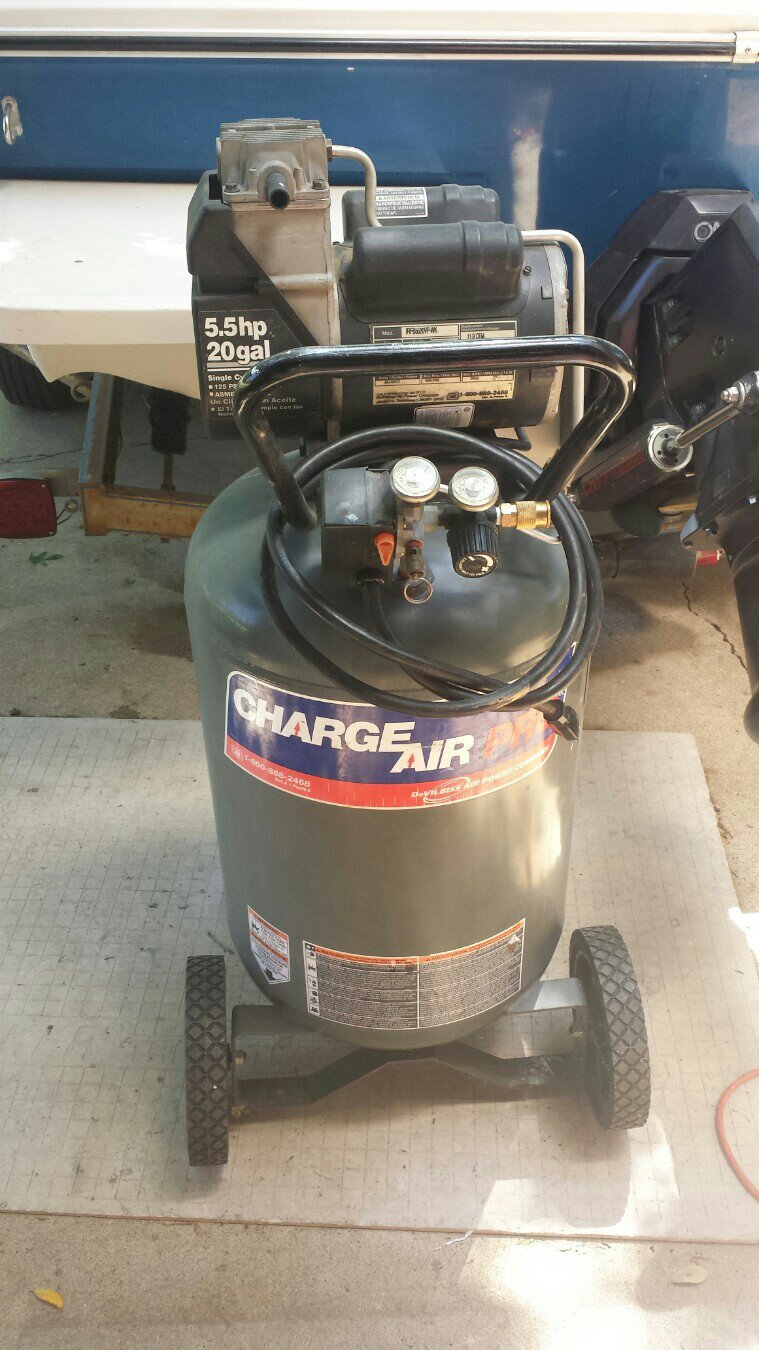

I opted to wait on a large compressor, as we are planning on moving from Texas to Colorado in about 6 months. Wiring up a new 220v outlet for such a short time seemed like a waste. Patiently searching craigslist paid off. I picked up this 20 gallon compressor with Devilbiss motor for 100. Bought a rebuild kit complete with new piston, sleeve and o-rings for $45. It does 5.8 scfm at 90psi.

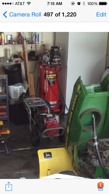

But at home I have a single stage 110 Home Depot version. I asked the same questions when buying mine. Is it big enough, is it strong enough , is it slightly portable for my needs.
My findings were this: Stay away from craftsman pumps with the motors attached to the pumps (kinda like the one you have). Because they aren't as reliable.
So I opted for this husky pro 30 gal.
I use air tools and sand blast cabinet, this one is pushing the limits. For cfm. But is great for tires and painting. ( short heavy bursts or small long bursts when I use my hplv paint gun.)
Other pic is one plus the other waiting to be installed.

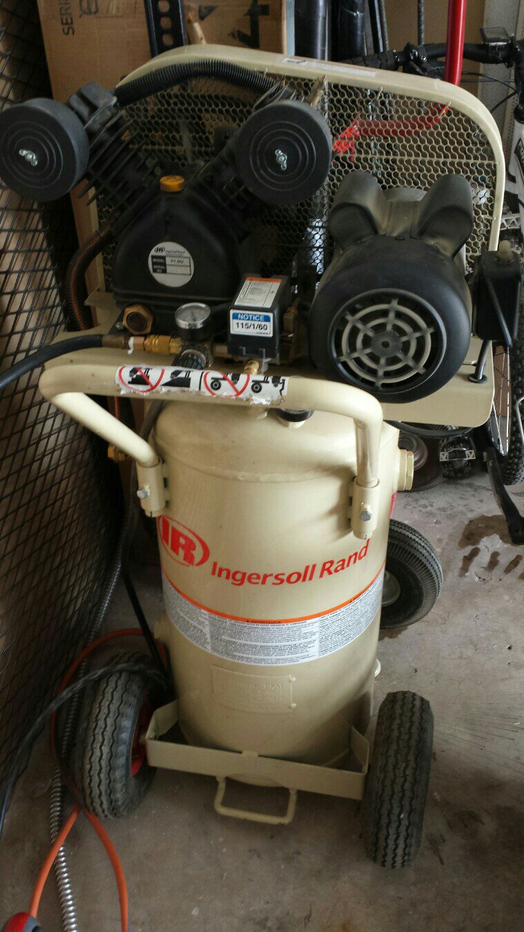

The little 20 gallon IR Garage mate I had been lusting after popped up on Craig's list. 1 Year old, delivered to me for $250. Airs up roughly in the same time as the other one I have, but 100% duty cycle, and so much quieter. I can run this one without disturbing the wife's slumber.
The first compressor got hot very fast. I was scared to push it too hard.
I will probably get my $250 back from selling the first one.
That is a steal. Did the PO feel like they needed to give it away?
My brother has the same one. Loves it since he has no dedicated 220v outlet for an upright. The one problem he told me is that it hated to be started below 40F in his garage until he switched to using synthetic oil in it (I think he uses Royal Purple). Now, good to go.
