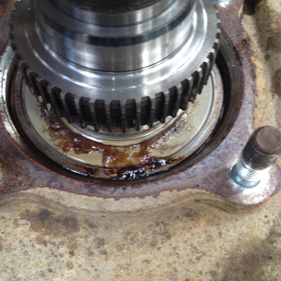

Here is a photo to illustrate what the guys have mentioned about the grease.
This is from a very minor axle seal leak. Just a little oil in the ABS cavity, none as far as the brakes. If you are seeing oil in the brakes, consider the bearings to be ruined (or needing repacking if you go that way).

Think I’m a victim of a botched axle seal job... had all the parts [MENTION=120071]mtbtim[/MENTION] suggests in his vid... bearings, and gears, retainer rings done on both sides a couple months ago and found this on Saturday
At least the passenger side is dry! How long do I have before the new bearings are washed out?
P.s. did the diff breather-mod too so vent is good
If you have that much oil in there, the bearing is already compromised. Sorry to tell you. See my pic above, I had a lot less oil than that in mine and the bearings were lacking grease. If they are new bearings maybe you can repack. Others have had luck doing so. My bearings were original so I replaced them.
This issue is a b!tch. Such a headache for people. Once fixed correctly it seems to stay gone at least.
