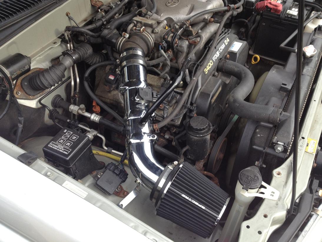

So I just put in a cold air intake (spectre, had to stick to a budget) and a magnaflow straight through muffler. The muffler has been on for a while. So a few hours after I put the cold air intake on, the engine threw a code P0171 saying the system is too lean. Does anybody know any tips or ways to adjust the fuel air ratio, or a tuning technique to fix this? (Chips, tuners, anything)
Checked all fittings and clamps, everything is sealed as it was when it was new. I'm assuming the air filter is allowing it to breathe to a point where the computer isn't able to keep up with the air flow. Any other suggestions?

Post pics. Maybe we can see what you did wrong, if anything.
If it's throwing a code the O2 sensors are probably showing lean due to an air leak or something (dirty maf possible). There is no relearn needed and there is no more airflow. If it's showing lean there is a problem.
Okay. So I took the intake off and made sure the seals between each piece are in fact sealed, and double checked for any other leaks. I cleaned the MAF Sensor with the cleaner from advanced auto parts, and I disconnected the battery and removed the corresponding fuses. Does this cars ecu actually "learn" as you go? And how long before it is properly programmed?

Forgive me if I'm wrong, but that looks like one of those "universal" diy spectre intake kits?
As someone else mentioned, swap the section that contains the vacuum lines with the section that the sensor is mounted on. Right now you are letting in unmetered air. I'm sure that is the issue.
If that's not it, I do have some experience with this same style of intake system. Those coupling clamps don't seal worth a damn. I smoke tested the intake system on a 5.0 swapped bronco that had a lean/no start backfire with one of these intakes on it. Smoke came out around every clamp. sealed it up with silicone, returned the idle screw to where it should have been and the same with the distributor. It fired right up.

The vacuum line with the shiny new hose on it goes after the MAF (the other one before the MAF as you have it).
The other possibility is that the Spectre MAF 'section' itself is the problem. One trick CAI makers use is to increase the diameter of their MAF section slightly, which fools the computer into thinking there is LESS airflow than there really is, making the mixture lean. On most stock engines, leaning out the mixture a bit at WOT will gain a slight amount of power (which is where a lot of the CAI 'power increase' claims come from). The ECM will generally relearn the long-term fuel trims and adjust for normal driving, but the short-term fuel trims will always show lean, and sometimes throw a code.

I put the vaccum lines after the maf and sealed the clamps around each piece. It seems to be fine now. Hasn't thrown a CEL. So I think this fixed the problem. Thanks to everyone!! Toyota4Life!!
