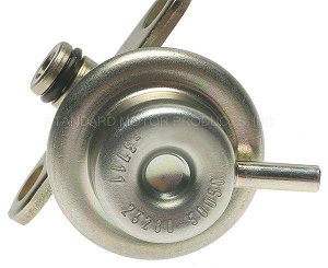

I have replaced the fuel pulsation damper but I still have the cold morning noise. I bought Mechanic's Stethoscope (Mechanic's Stethoscope | Princess Auto) and I believe the noise is coming from the fuel line where the fuel pressure regulator is attached to and looks very similar to the fuel pulsation damper.

Thanks Nathan, the regulator costs $104 from Partznet.com + shipping. It worth trying to install it if it helps fix this "cement mixer" noise (Drives me insane), I just need to double-check in a cold morning that the noise is coming from it. I noticed the fuel lines attached to the body right behind the driver's seat where I can hear every other morning.

This is the fuel pulsation damper (I replaced it as well with no success). The one I'm talking about is the fuel pressure regulator, it's located on other side of the fuel line, here the part number: 23280-50050
Please check the diagram I attached in my previous post with the picture. I wonder how could I replace it without removing VSV that is right above it.

I replaced the fuel pressure regulator and I still hear the noise in Park (Louder in Drive or Reverse) when it's below 0C. It can be heard only from inside the vehicle with closed doors and windows. I do not know where else should I look at. The noise comes somewhere behind the steering wheel. Maybe it's a manufacture defect that no one knows what is it.
