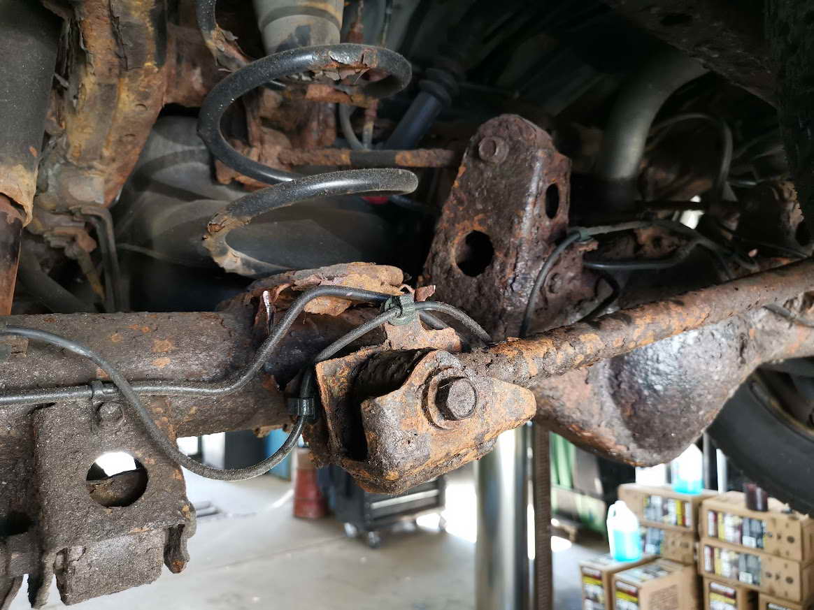

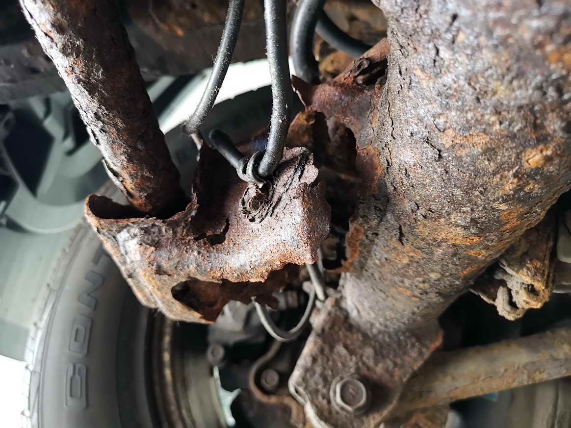

So I thought it's a lousy brake line job. https://www.toyota-4runner.org/4th-gen-t4rs/306185-brake-failure-please-advise.html#post3746018
But it's the "rear differential stabilizer bar rusted off ripping out the brake line" said the mechanic. He also said that he doesn't know how to fix it. Or even if he knows he would not recommend it because other rusty parts may fail too. Ironically that I just had the leaky transmission line replaced there last week and He assured me that the new lines should last the rest of the vehicle's life...
Now I don't know what the stabilizer bar does but can I by any chance drive without it? Something's coming up and it would suck without the 4runner. Can we survive 2 weeks and perhaps 200 miles without it stabilizing for us? What if I drive like a grandma? Ok NVM I think that's a bad idea...damn
After that I plan to park it and join one of them classic lawsuit about the rusty frames. Are there multiple ones going on? Any suggestion which one to join?
Thanks! Still mad...
Well then again I guess I am Lucky because it happened when we were so close to home and nobody got hurt. It could have been so much worse...

It prevents body roll. You can drive without just be careful cornering. Looks like your coil seats are about to blow out too sh1tty. You won't win a law suit the judge will just say it's want maintained properly. I agree it's BS. There are way more durable coatings Toyota should be using.

FYI, If it was the “sway bar” you could get away without it. It would affect the runners cornering ability on the road. What you photo’d is the rear axle track bar mount. It keeps the axle centered under the truck. Without it the axle will wonder under the truck and you in affect would have no proper 4 wheel alignment. To vehicle could dart all over the road. Serious issue. And serious rust under there. Sorry to see it.

Based on this and your brake failure saga, I'd say this unit is totaled. I'd be surprised if it doesn't collapse during the tow to the junkyard.
yea man... sorry to see.. but that's a hard nope on driving it.. it's finished.
Your panhard bar is no longer attached, or at least close to it. And as mentioned above, this is literally the only thing keeping you rear axle from shifting laterally.

Thanks guys for the info. You are right about the broken part being the rear axle track bar mount. So I won't drive it.

yes, that's the track bar not the stabilizer bar. you can't drive that anymore. you can however get the rear differential replaced and you should be back to normal but before you do, is it worth it? I'm sure there frame there is disintegrating too.
Depending on the condition of the rest of the frame structure you might be able to hit up the local Pick a Part or check Marketplace for one being parted out. Judging by just what I can see in the single pic, I would say the days of this vehicle being road worthy are done over. Just my .02 YMMV?

The panhard bar does not prevent body roll. That what the sway bar does. The panhard keeps the axle under the truck. It should not be driven without a panhard at all. Not even slowly.

I think you're talking about the sway bar removal. The panhard needs to be there. It locates the axle under the vehicle. The rear control arms, the drive shaft, and the coils are not designed to hold the axles position under later loads. It will fail.
