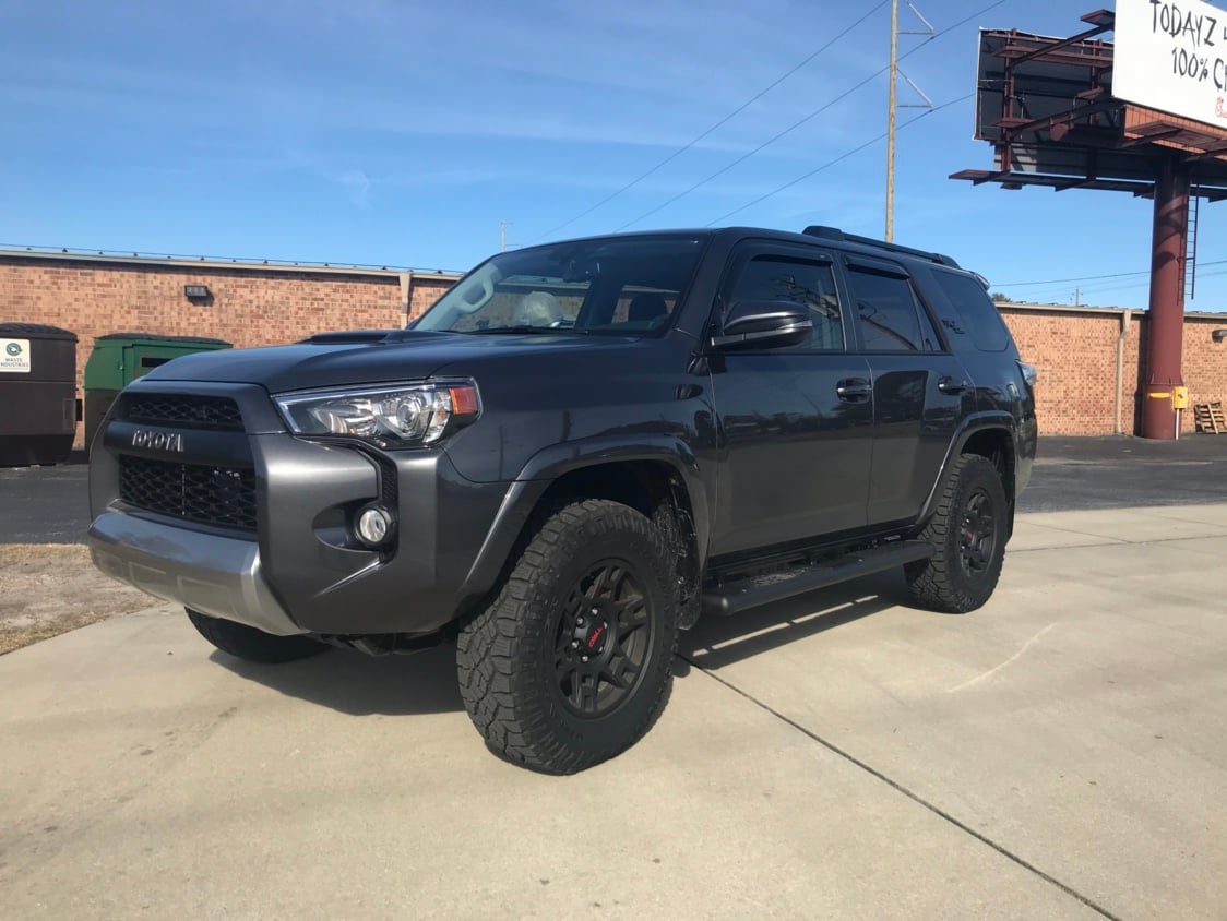

I installed daystar 1 inch leveling kit at the front and 255-80-17, xreas. I also have 1 inch spacers for the back that I'm too lazy to install. To fit my tires I removed front mud flaps, moved forward wheel well liners and trimmed inner trim where my mud flaps were. Almost no rubbing. Street driving no rubbing at all, just when offroad.
