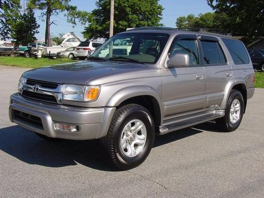

I've been looking a while for a 4runner, specifically a 2001 or 2002, and I finally came across a 2001 4wd limited with 94,000 miles. It is super clean and according to carfax it has never been in an accident, but you can't always rely on carfax, but it has had 3 previous owners and the first owner only had it for 2 months. Should I be worried or should I go for it? HELP!

Looks like a nice truck. Not normally a fan of the 99+'s but that looks good. I like the colour.

They are asking 11,000 for it which I think is pretty good compared to some I've seen. Also, I checked on the recall and there are no recalls on this 4runner. I checked on the toyota.com/owner website.
