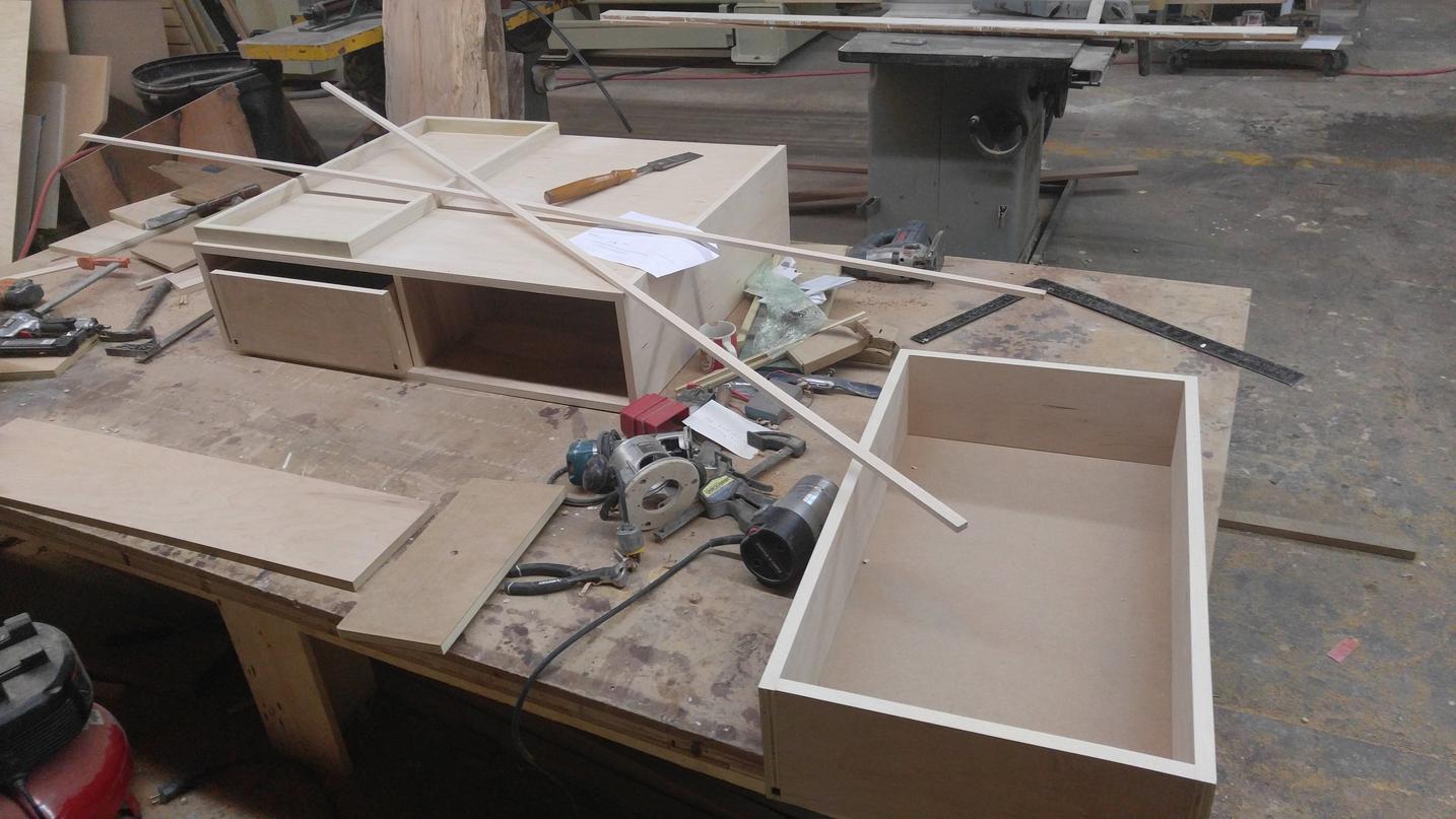

Working on my birch drawers now. With full length heavy duty slides, this is getting in the $500 neighborhood as a diy. Doweled with dadoed drawer based though, so it will be nice and strong (and heavy AF). Still deciding on finish and best way to secure it.

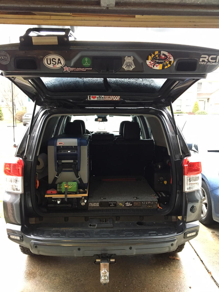

Hell, I didn't keep track, but I bet my latest version of my storage unit cost me less than $300- including the starboard and slides (not including fridge, lol).
I will admit that the slides (Home Depot full extension) are not exactly great, but they do the job. You just have to be creative. For example, the latches I used to hold down the hatches are cam latches from an old electric guitar case. The carpet is from the bulk roll at the hardware store. The tie-down loops were from a yard sale. That's part of the fun...
Expedition Storage Box
Updated Storage box
