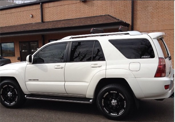

Hey guys.. I know there is a lot of posts related to this but still not enough to convince me either way...
I have an 03' Limited V8 with 265/60/18 tires.
I am looking at either doing a:
-OME 3" complete lift or
- Bilstein 5100 adjustable coilover complete lift (Toytec/Eibach Springs)
all from Toytec
Either or I will most likely add Light Racing Upper control Arms because I want this thing to drive perfect. I am anal about it being right.
About me: Daily driven but anticipate medium to tough off road trails as a weekend warrior. I live in Colorado and will see a lot of snow/ice. Dont intend on adding too much extra weight (maybe a custom rear winch someday). Prices are so similar lets assume that it is not a factor.
