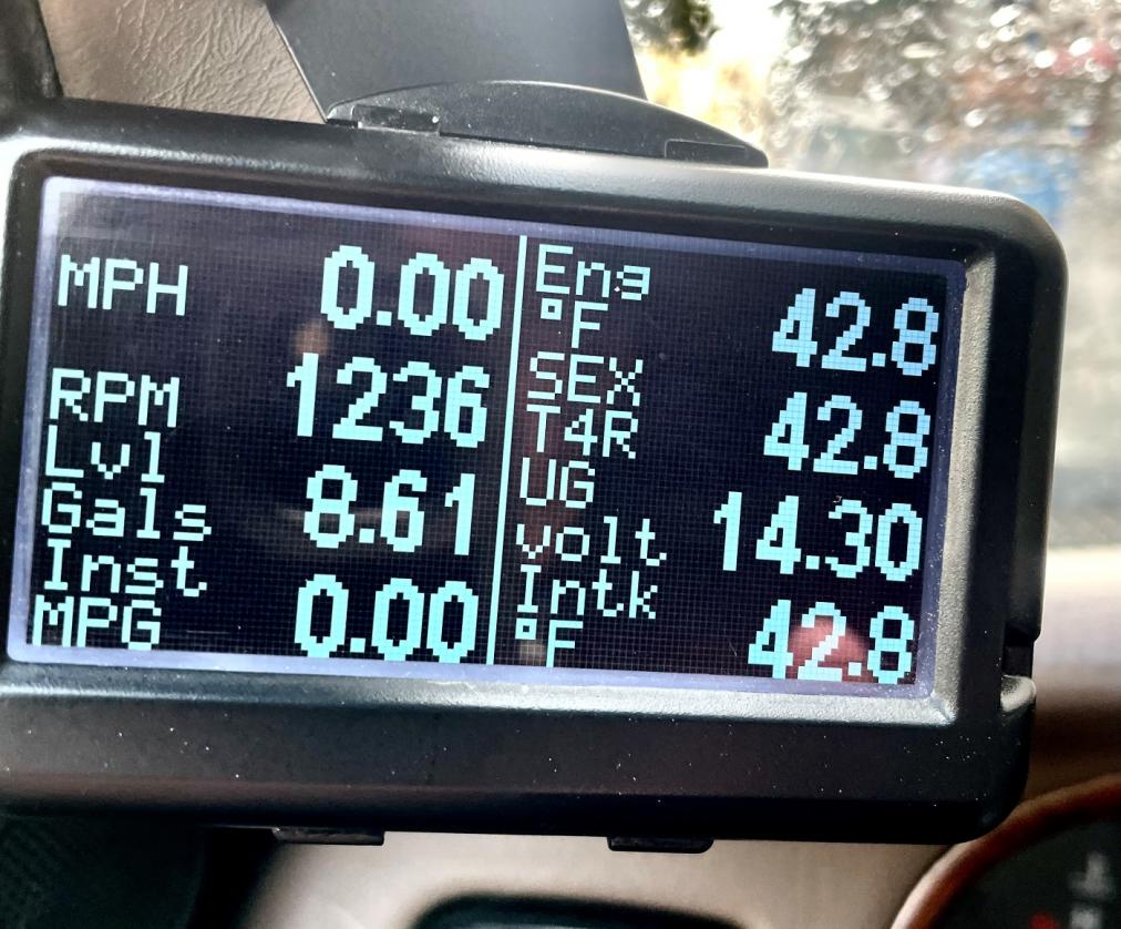

Edit: easiest way to confirm if that’s your problem is to look at the intake air temp and coolant temp at cold start.

I've read on these pages that you want all readings to be pretty much the same at cold start. I took this photo yesterday AM because we're freezing balls down here in CA! :smow:
