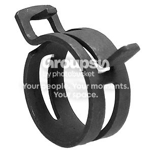

Dump the crappy screw-clamp and get a properly fitting constant tension clamp. There is a reason why Toyota uses those instead of the screw clamps because the constant tension clamp will maintain a constant tension on the hose while the hose expands and contracts with heat/cold. Screw clamps don't.

Agreed a spring type clamp is a better choice.

You should go out and measure the diameter of your radiator hose and then just Google search or search Amazon for a constant tension clamp that has an inner diameter (ID) that is the same (or very close) to the outer diameter (OD) of the hose. You may want to consider getting one for your lower hose too if it doesn't already have one. Actually, maybe find one a little smaller so that it has good tension and has to expand a good bit to fit over the hose.

Thanks again Woody for the info....I had just **assumed** that those clamps were something unique to Toyota.
