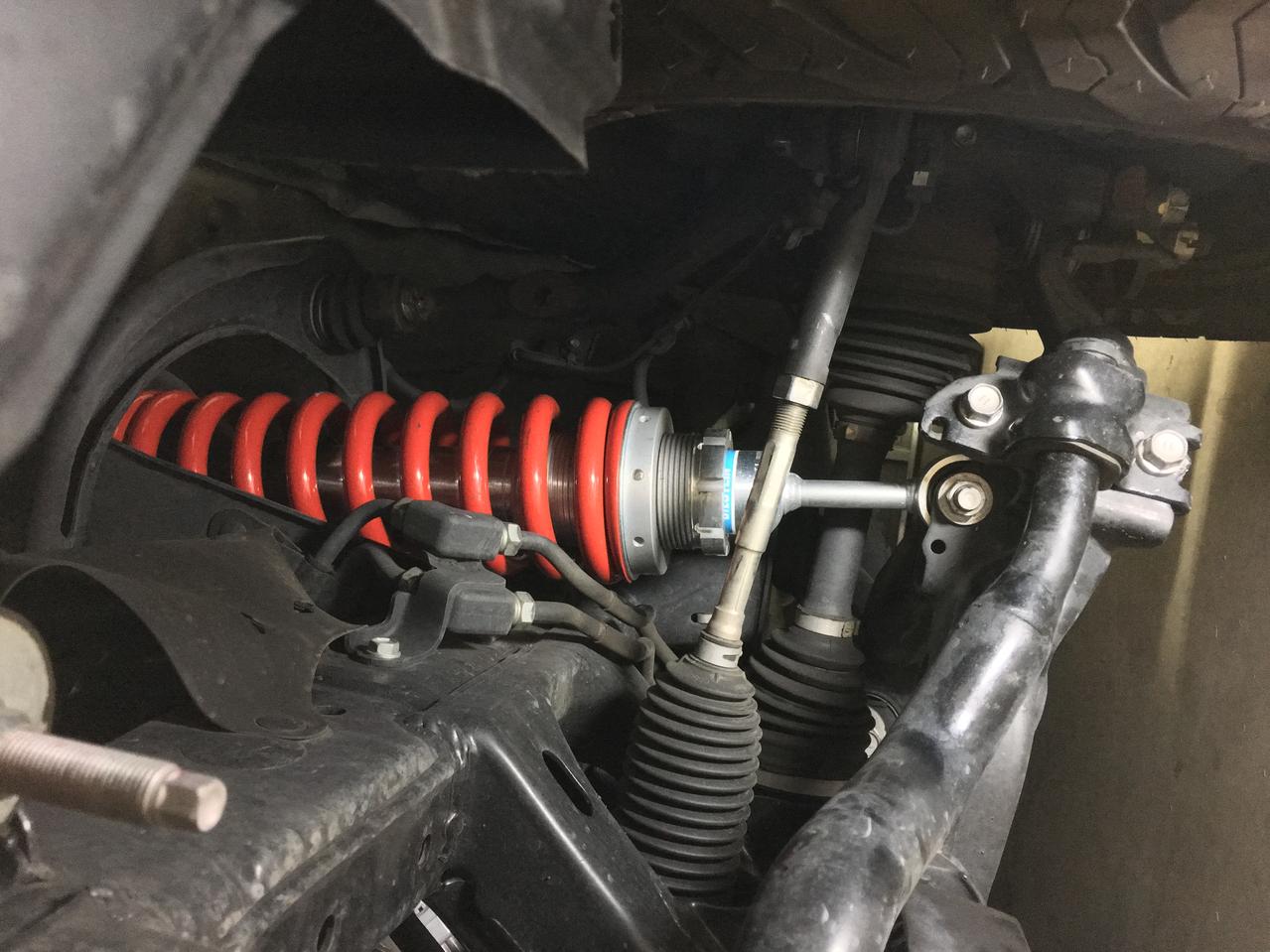

I had these installed along with 5100s in the rear for 350 total at Offroad direct.
