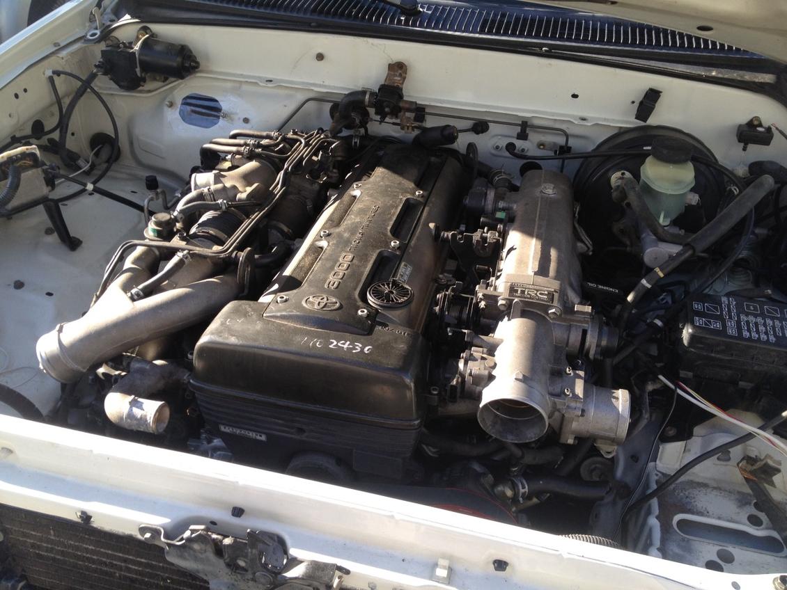

local guy on cl swapped into his tacoma, thought about doin this in a first gen, but then a 3rd gen would be badass too, any thoughs?

The supra used the same automatic transmission but with different gearing for the a couple of the gears. So take the bell housing off of our transmission get the bell housing for a auto 2jz supra and bolt it together so you can easily save 4wd and some cash by not buying the transmission. That engine is also in the lexus GS IS and SC so there are plenty out there. I consider it 2 times a year when one pops up at the local junk yard. Also if anyone is looking for a engine PM me I might be able to find it here.
It'd have to be a standard tranny, cause if I need to take it easy on my auto with a stock 3.4 supercharged, it'd never hold up
