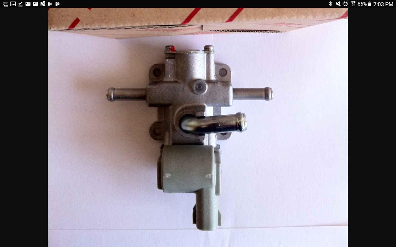

Is the IAC the small pancake valve on the rear passenger side of the throttle body? The reason I ask is, as a test I did disconnect that vacuum line just to see if anything would happen and the idle did increase by about 500 RPM to 2000 RPM. Unfortunately I don’t know if that still says it’s good or bad or what it even is.
the pancake valve I think is fuel pressure regulator. the I ac valve is below the TB and has passage leading into it it looks like this
No.
It's the little gizmo underneath the throttle body, near the intake tube that comes from the air box.
