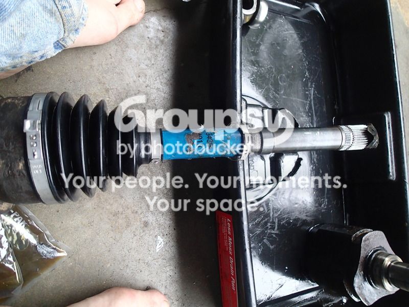

That plier is made to work with the small clamp pictured here:
P5287188_zpscwo1l5xv.jpg~original
The other type is a band clamp, tool part number post 8ish on the re-boot link.

I'll answer my own question, in case it will help anyone else... Yes, those are the only pliers I needed to clamp the bands used in the Napa kits I bought.
Question... I had the passenger CV removed and that side was a little higher than the driver side, but I still lost enough front diff fluid to create a medium sized wet spot in my garage. I should be ok with that little amount of loss, right? I would like to avoid taking the front skids off to top off the front diff fluid. Thoughts?
So your kit came with 2 ear-style clamps. Cool.
