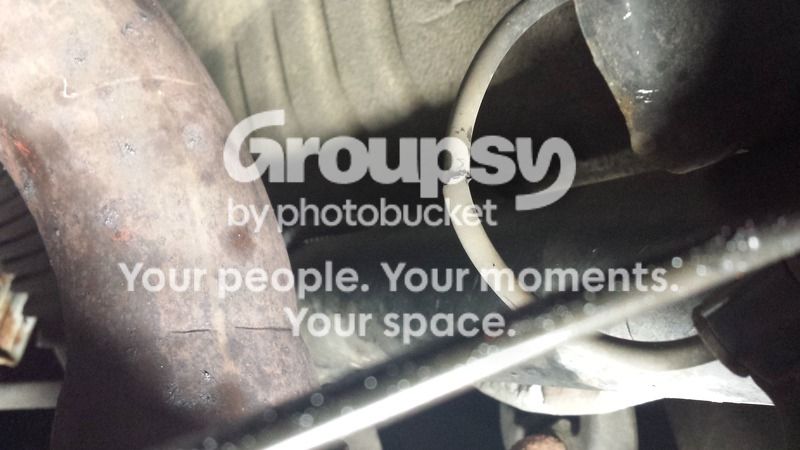

While I was installing the SS 1.2 lift today on the rear end, I was cutting the old shocks off the passenger rear with a sawzall and it slipped and cut a white/gray wire, this wire runs along the backside of the rear axle into the rear drum brake area.....Dang, what did I cut, and any idea about the best way to fix it? Thanks for the help.

About $175 online for a new one, $240 and up at your local dealer.
May want to try Ebay or the local junkyard for a used one.

[MENTION=126994]gergg[/MENTION] Lots of part outs in the classified part of the forum. I'll bet you can pick one up fairly cheap.
I have the same question too. Is there just one wire in there or a bunch of little ones?
If it were me, and it was just one wire, I would use a butt connector and some heat shrink to make it water proof.

You know, iirc the single line is just insulation over 2 tiny wires....why would this wire not be splice-able? Just typing out loud...
To replace that wire and sensor the connector should be right above that cut, at the top of the shock mount so easy enough to pull from a yard if you can find one with an axle still in it, you won't have to dig so far to get it all out.

Looks like a perfect opportunity to practice soldering. Not like you could make it worse at this point.
Yea whats going on here with all this replace the sensor talk. We are men/women made of brawn and steel. We can fix anything.
cut back that plastic and solder/shrink wrap that wire(or crimp whatever) and your good to go.
No need to replace anything, a fix is in order.

The 2 wires in there can be easily spliced. My 2000 came with the passenger side rear spliced with no ill effects. Soldering is best, but butt connectors would work. Shrink wrap is the way to go.
