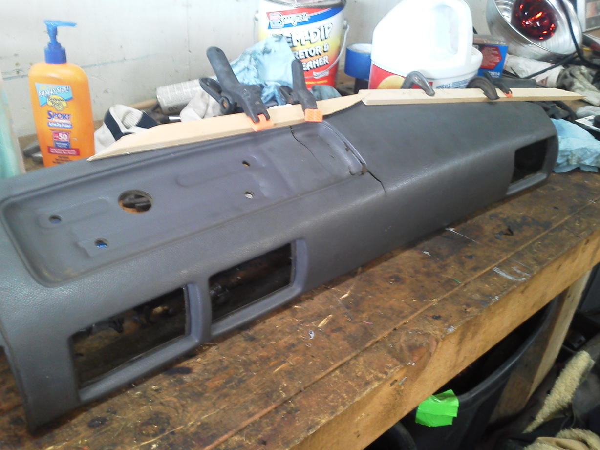

Here is the patient all splinted and glued up.

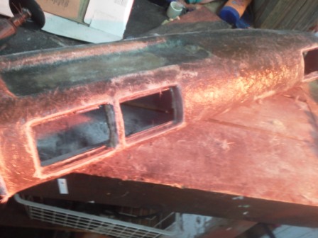

I excavated the loose material and filled the void with Gorilla Glue. I used it because it foams up as it dries ad really filled the cracks and,,, you know, it's made of gorillas so it must be pretty strong... This is after I sanded it.

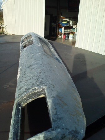

This is after I slapped 1 sheet of Bondo brand fiberglass mat and resin from Autozone.

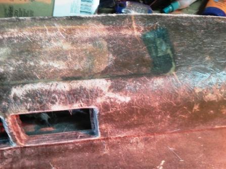

Sanded with 80 grit. Guess I'll slap a lil Bondo around before I sand it again...

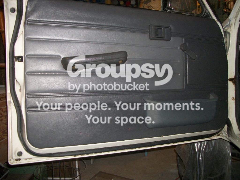

You should have snapped it up. I've had good luck recoloring a couple of interior parts with Duplicolor interior paint from Autozone. In the following picture the door pockets were once blue. Two coats.

Cometobanks: good project. If you are using any Bondo make sure it's thinner than a dime or it will crack. If it needs to be thicker maybe try the Bondo with fiberglass fibers.
