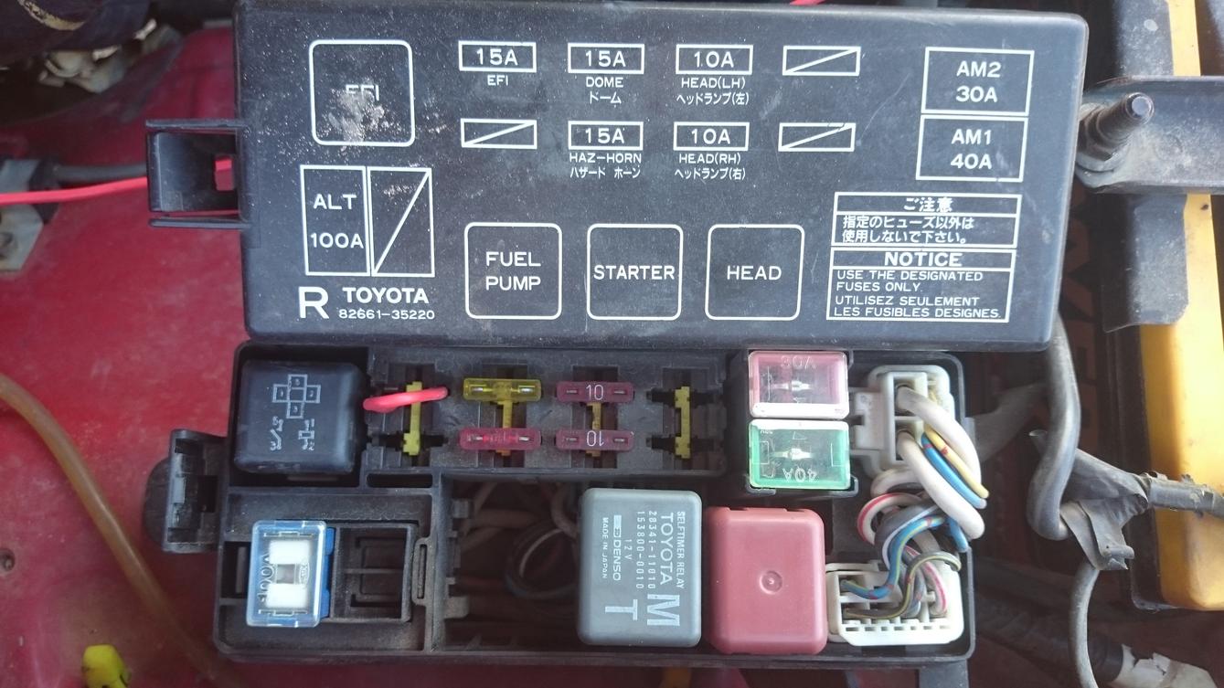

You did not mention what model you have, 5 speed or auto, 22re/3vze/2lt/etc.. There are a few other components depending on what you have. Here's a visual of all the parts for the fuel pump on most '80's/90's toyotas:

The relay in the fuse box in the engine bay is missing, no relay, no plug for a relay and no wiring there. so i have no idea where that one could be!

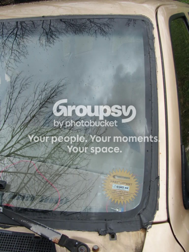

The water usually gets on your circuit opening relay through the bottom of the windshield, near ubiquitous problem. Dunno about RHDs but suspect they're the same. If you have water there you will also have water on the spade connectors at the relay backside which will rust and increase resistance and heat and eventually melt the wiring. You need to stop water getting behind your dash. Here's the fix -
I've fixed this issue on multiple vehicles without recurrence, for up to four years and counting at this point. First pull all the trim around the entire windshield, then scrape all loose rust using a screwdriver and run a rough sandpaper thoroughly over it. If you need to paint any areas make sure they're extra clean. Blow out the joint and treat with phosphoric acid per directions on bottle (or as a second choice, any phosphoric acid containing primer).
If you can't cover the entire affected area with caulking and need to paint, follow acid treatment with primer and paint. Let dry and then masking tape both sides of the joint all the way around the windshield and fill with Dow Corning 795 silicone sealant. This is not your typical hardware store caulk, it is professional glaziers sealant and makes all the difference - does not shrink or oxidize at all and has unsurpassed adhesion and flexibility. It's sold by industrial supply stores, or online at Amazon, not cheap, but worth it unless you want to do this every year. Finally, tool the joint with a plastic putty knife, and throw away that worthless, water-holding trim.
My windshield, before cleaning up the joints after it dries -
