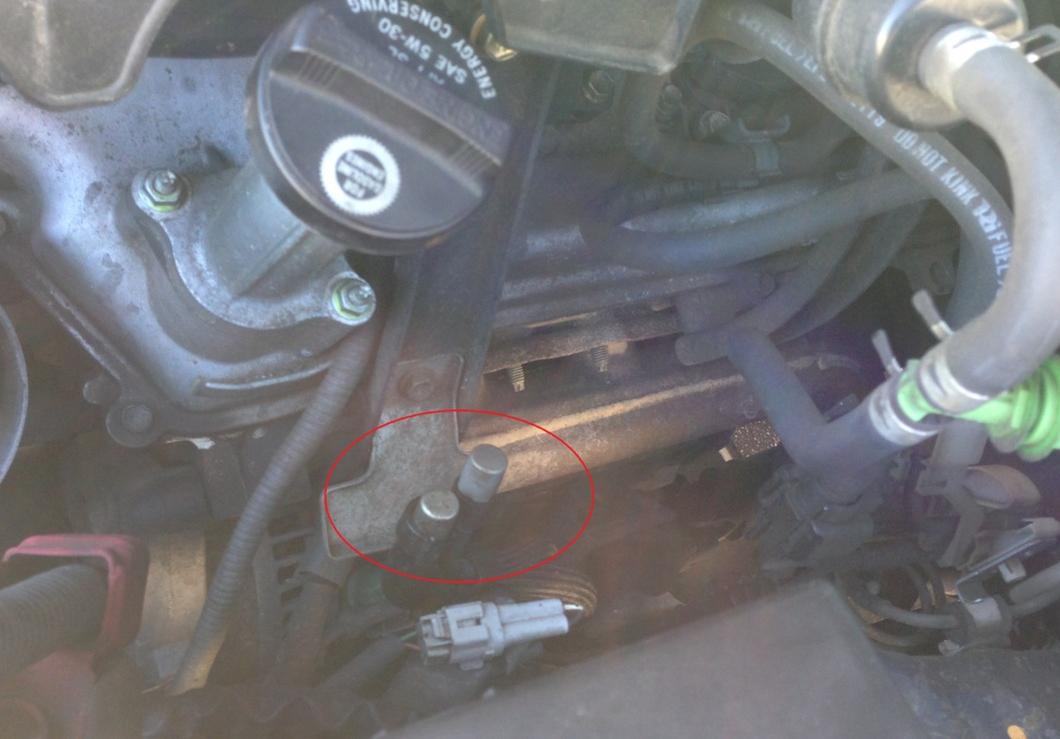

Tranmission Part
Is this part of the transmission? I have oil leaking from this.
Those are the breathers for the front differential and transmission, they shouldn't be leaking oil. But, it could just be aerosolized oil and ATF that have migrated up the tube and over time and made it somewhat oily looking.
