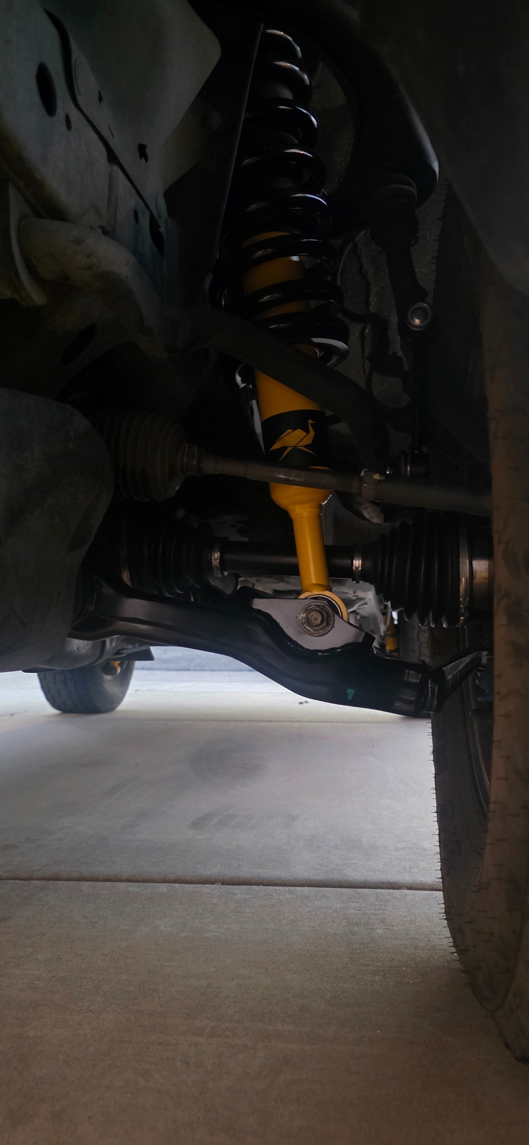

Anyways... since im keeping it, I detailed the inside, tinted the windows, and put on an ARB 2006K kit.
Now it needs a little bigger tires... then new paint, then ive been looking at maybe an OBDII trans temp gage for when im pulling my boat on hot summer days... what other mods should I do for my bass boat hauler?

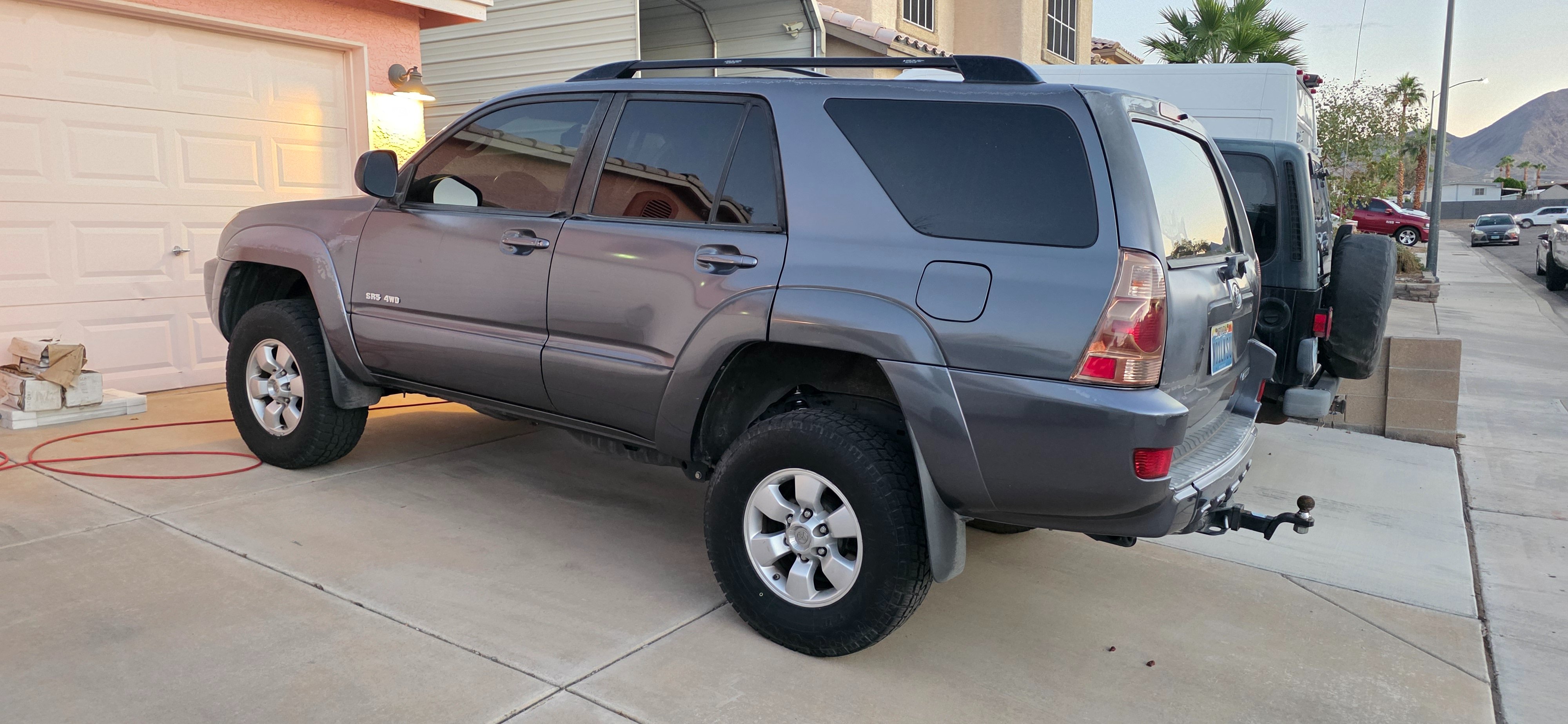

Not a speck of rust on it, its been in vegas its whole life.. but because of that the clear coat is half gone. Just did the timing belt. And yes I think its cool that its old.

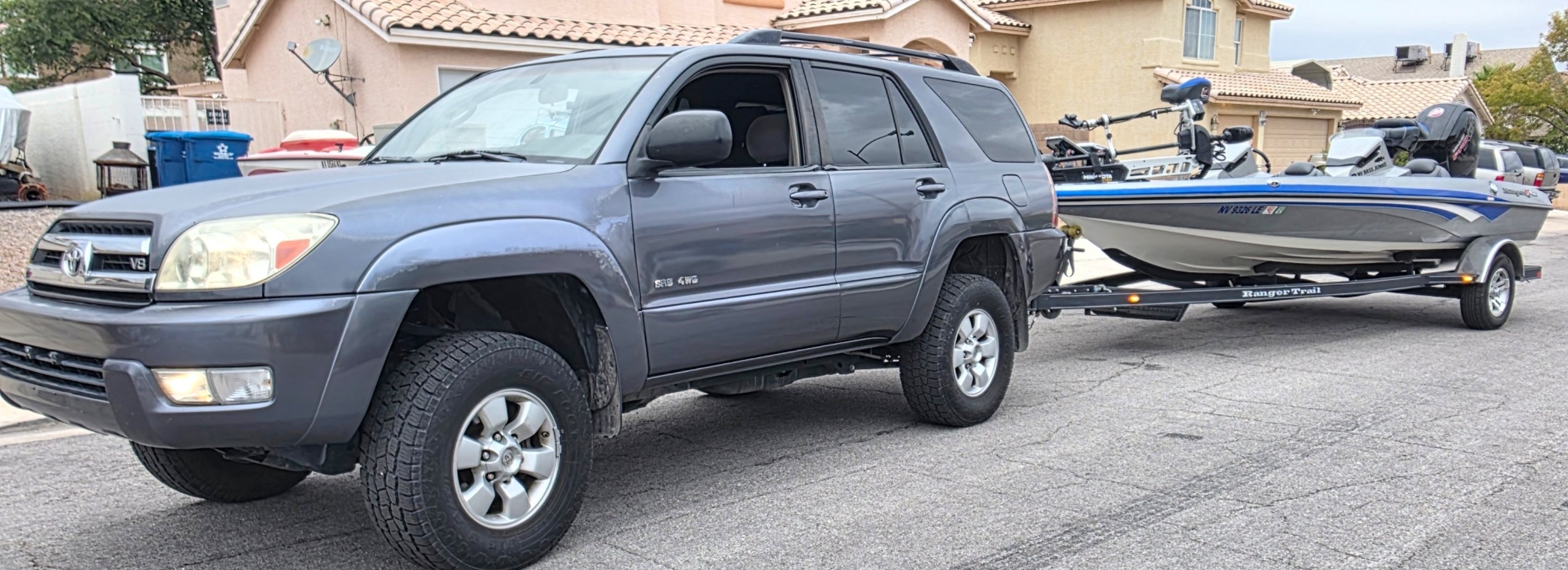

Just washed my boat, the +330lb ARB springs really keep it from squatting now when towing. It feels really good. Before you could really tell there was a trailer attached. Now its almost no difference

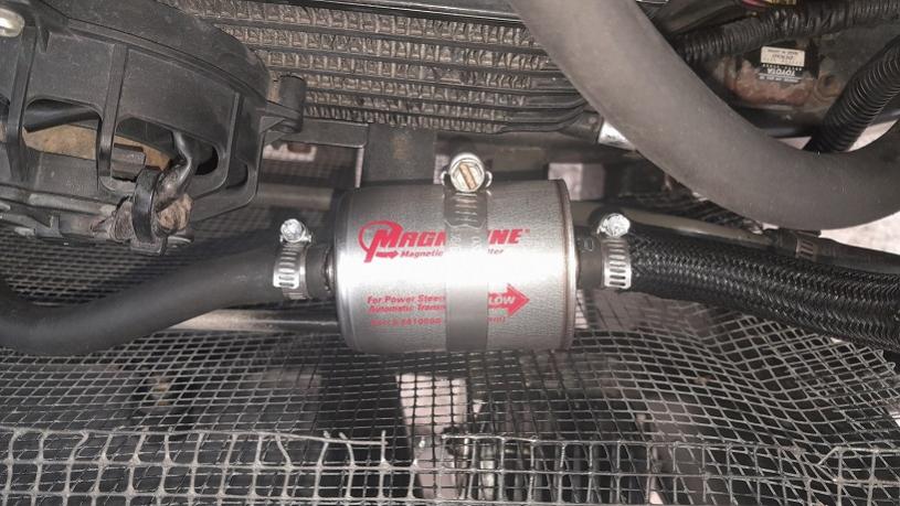

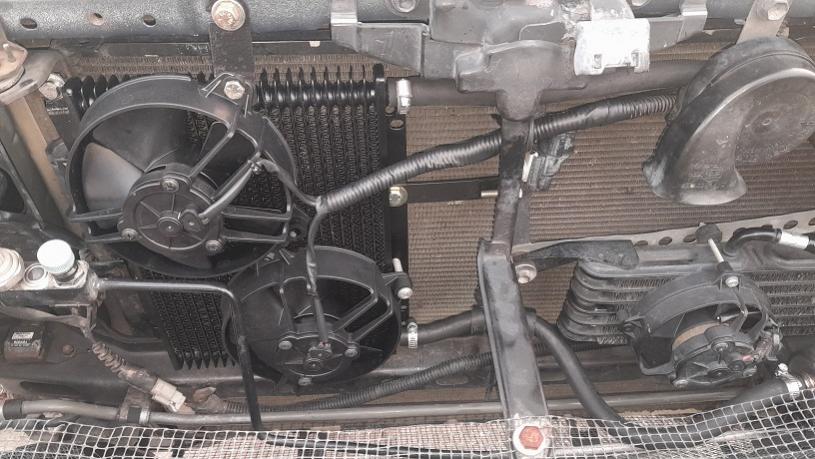

Since you've been towing and this will be it's main usage in the future, do a drain and fill on the transmission fluid for the peace of mind. For OBDII trans temps, I've been using Torque Pro for years, but there are a lot more options now days. I added a larger trans cooler with a couple of Spal pusher fans due to the soft sand I frequent. That will jack your temps up higher much like towing does. I also put a Magnefine filter in line on the trans fluid. Highly recommend these mods. I also put the power steering fluid thru the old OEM cooler as well. One last thing is to exercise the transfer case and center diff lock quite frequently as these have a rep for the servos getting sticky and then not engaging. I swapped mine to a manual shift case. Good Luck, and I think you'll be pulling your boat with the 4Runner for many years to come.

Aquasport yes I think I will throw a trans cooler on it. Long hills coming home from lake mohave and mead, and in the summer its 115 out sometimes. I ended up doing that for my automatic in my wrangler after burning the fluid a few times, in the sand. The extra filter is actually a really cool idea I would have never thought of it.
